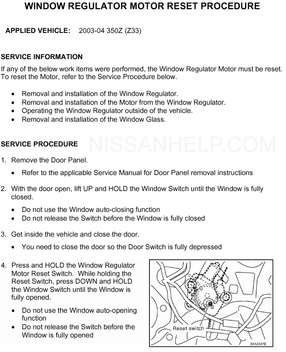

Does anyone know how to time the windows in the Z? I had the window roll half way down after rolling it up before but that was when I was under warranty. It only took like 10-15 minutes. And now it is happening again. I am wondering if all it is is like a set screw or like adjusting your garage door opener. I cant imagine it would too dificult. I was just wondering if I was way off on how to adjust it or not. Thanks

You have to take the door panel off. Then there is black circle cutouts on the panel where the window motor and regulator are. Remove the circles in the middle till you find one with a button behind it. Then close the door, raise the glass to the highest position. Then press and hold the reset button while you lower the window to the lowest position without using auto mode. Then let go of the reset button and raise the widow to the highest position without using auto up. Put back door panel and your done.

here's a detailed guide, that just repeats Blue 03 Z's post!

Nice! I'm going to try this tomorrow.. I noticed my windows not going down like they use to.
Thanks.

just did it, it only took 20 minutes because I was being extra cautious--after being scared to not break any snap-tabs, but they didn't get anywhere close to breaking, whew!--but it's damn easy and my window rolls up perfect again without that full-up-then-half-down problem...for now at least haha!
