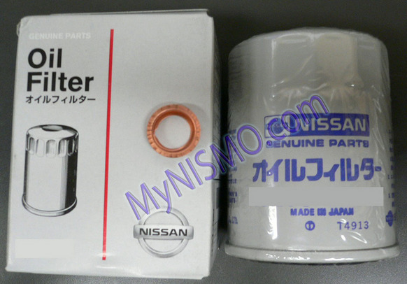

do NOT refer to them as "crush" washers. I went to performance nissan and said "I need the washers for the oil drain plug", to which i was told "oh you need the crush washers". I was like "er..yea i guess"... went home & realized an O-ring & a crush washer are not the same.
The crush washer is smaller than the O-Ring, meaning it will not fit over the bolt that screws into the Drain plug.
The crush washer /aka/ oil filter washer is a perfect fit for the oil drain plug bolt, but thats it.
You need O-Rings for the drain plugs.. I will take a pic of a crush washer when i get home & post it tomorrow...
Isn't this thread about the oil drain plug?
Attached is a pic of the copper oil drain plug crush washer.
Here is a link: Nissan Oil Drain Plug Washer
http://www.mynismo.com/products/?id=4935
And here's a link to the transmission/differential drain plug metal o-ring (non crush) washer:
Part number
110264n200
site: http://www.trademotion.com/partlocat...52&catalogid=0

oh yea i saw oil and jumped... just wanted to make sure no one made the same mistake i did...
oil filter-> crush washer (yes)
transmission/lsd -> O-Ring
