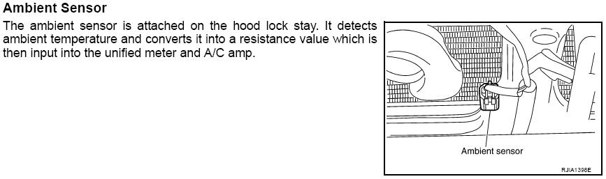

If it was wrecked, then it's very possible that they didn't hook it back up, or it was damaged and they didn't realize it. See the diagram below...
Excellent Dave. Thanks for the diagram. That is great! I will go outside now and take a look at it. Thanks bro.
Yep, the damn sensor is missing. There is just a female plug end. Ok, that explains it. Thanks Dave.

What does that ambient sensor all control? According to Dave's diagram is sends info to the unified meter and the A/C amp. So it controls the A/C as well? Hmmmm, maybe that is why I have A/C issues? Then again I get no cold air at all, just warm air even when the setting is all the way down. Sucks in the summer as it will be about 90 this weekend. That LED always says icy because the sensor is missing. I bet that is why I am having the VDC problem because the system thinks it's icy and the VDC kicks in?
