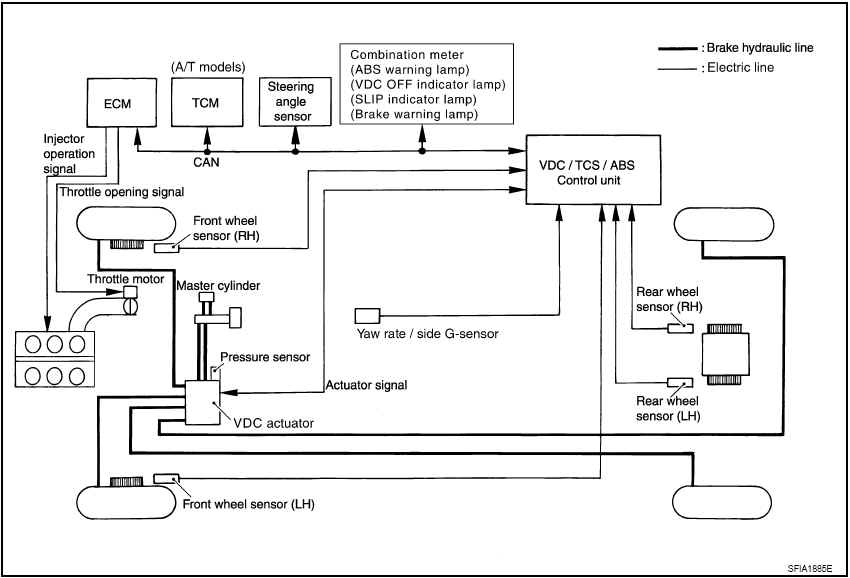

I believe it's connection to the A/C allows it to automatically switch between outside air and recirculated air when controlling the temperature. There should be no conection with VDC. VDC works from the wheels sensors and the G-force sensor, see the diagram below...
Damn, these diagrams are great, thanks bro. I just printed it out.
Ok, it looks like the g-sensor is located in the middle of the car. Is it located under the exhaust mid pipes? Where is the VDC/TCS/ABS control unit located? I'm thinking either the g-sensor is gone, damaged or disconneted. What do you think? When VDC is on the car loses power and limps and makes horrible noises. That's why I was thinking the VDC system was influenced by the ICY reading. The only way to drive the car is with VDC off.

The G sensor is actually under the console, next to the shifter. The wheels sensors are on the axles and are separate from the PSI sensors which are in the tires.
In most cases, when a sensors goes out, you will either get a CEL/SES (check engine/service engine) light or a failure light in the case of the brakes/tcs/vdc. Some or all of the brake/Slip/VDC lights will stay on when a unit or sensor fails.
There's probably not much you can do with the g-force or abs/tcs control module except replace them. You probably ought to take it to a dealer and let them diagnose the VDC problem. Damn computers make it next to impossible to debug and find problems without a Consult II module that Nissan uses.
Yes, you are right. The VDC and SLIP light are on solid. So it seems like a sensor problem. Would you suspect the g-force or wheel sensor(s)? Now I read that when VDC is set to "off" it's not necessarily off. Is this true. I notice when doing hard corning I get a chatter sometimes in the front wheel where the weight is being transferred to. It's like VDC is trying to kick in or something.

Update. I brought my Z into the dealership and they put it on the computer and found that the ECU thought the car was steering at .37 degrees to the right. Of course this was probably stored in the ECU after the wreck it had before me. So they reset it to zero and now VDC works perfect, problem solved.
