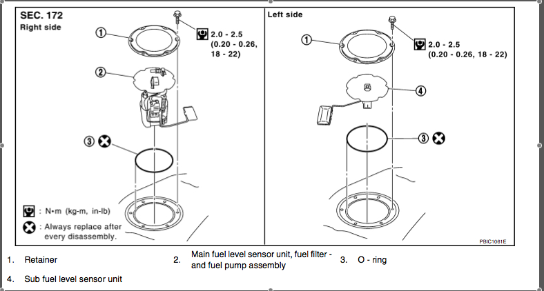

I searched my resources and just cant see how the fuel is balanced between the two sides, unless it is just blantantly obvious----There does appear to be a sending unit for both sides though. Pass integrated in the Pump assy. and drivers side a stand alone

Acree, what it sounds like to me is a fuel pump for sure.
As far as i can see from the service manual, the fuel sending unit and fuel pump are in the same unit.
I have a similar issue in my car, that im starting to think is a clogged fuel filter, but its interesting that my car is throwing the same code.
6 months ago, the car was running fine, but all of a sudden it threw two codes, bad 02 sensor and engine running rich. i replaced the 02 sensor and problem was solved. i know my car runs rich. I have the pop charger, and a custom welded intake that basically amounts to more plenum volume. on the other end i have headers, and test pipes.
now all of a sudden when i go to fill up, i only get to 7/8 of a tank even when its completely topped off, and i get the same exact code you get, and also a random misfire code on all cylinders. I had it scanned at autozone and the guy suggested that it could potentially be a bad coil pack. but i think hes way off. theres definitly something wrong in my fuel tank. it sounds like your issue and mine may be related. i really wish nissan made it easier to change the fuel filter rather then having to crack open the tank.

see if this helps you at all.
