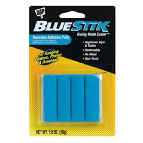

I used something a weeee bit stronger. Not epoxy, but Blustik.
Any adhesive putty like that will do. I got mine at Ace Hardware.

I'm so happy it worked for you guys, too! I can't believe we've been down this long road. We figured it out together, all of us.
What do you think would work best as a permananet fix? Epoxy? Silicone?
The adhesive stuff I used is just like the blue stuff you posted, but from 3M. I used to use the blue brand to dampen speakers and audio components, which is how I first knew of it.

Just tried Dap blue stik.
It didn't work for me.
Noise still there
Maybe mine truly is the suspension, and (gasp) the dealer is right.
