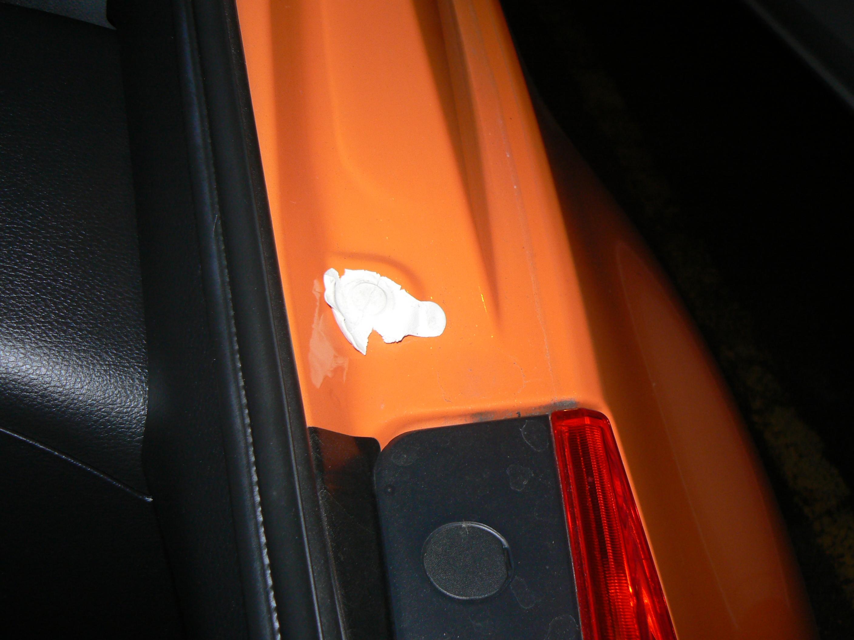

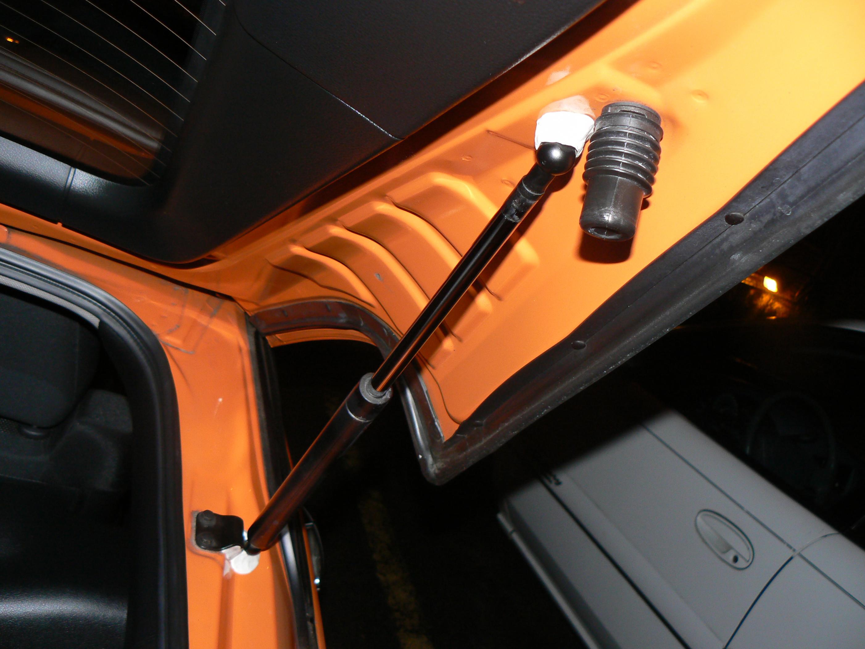

Good news this weekend-found and fixed the noise in the Z myself.
Turns out it was the hatch-some play in it allowed it to bounce and hit the body. It's NOT the struts themselves, but the hatch bouncing/wiggling laterally and hitting the body.
I took some of it apart looking for play in the hatch latch, but there didn't seem to be any. But I noticed the hatch itself had some play in it when you pushed it all the way up, even with the bolts that hold the struts on tightened all the way. It's a big, heavy hatch with not a lot to stabilize it and it's at a very low angle.
So, I plugged up the three places where it might bounce and hit the body with FUNTAC! It was perfect for the job, at least as a temp fix. After damping all the spots where it might hit the body, I went driving. over 40 miles so far -DEAD QUIET! Now why couldn't Nissan figure that out? I brought it in 15 times. Those were entire DAYS that they had to figure out the problem and they didn't do anything. I'm no mechanic, so the only difference is that I gave a sh-t
Now I just need to find the best way to fix it permanently. the Fun Tac is great to work with, but I'm sure it won't stay on. So I have to find some kind of silicon or foam, etc.
pics attached!
pics attached!
Sweet mother of God!! IT IS GONE! It's f*cking gone! I could kiss you, captfantastic! I went and hit the hardest and worst potholes I could possibly find. I hit them all. All of them. Nothing.
