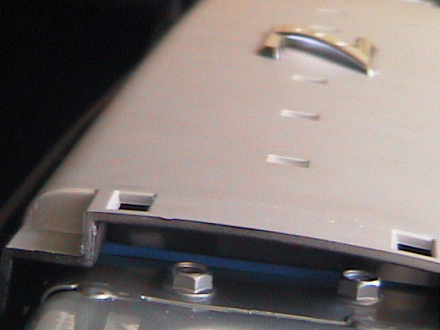

This is an easy fix. I had the same problem that only got worse once I installed the stiffer Nismo suspension. The rattle is coming form the rear strut brace. there is s piece of plastic that "slaps" aginst the brace when you go over certain bumps.

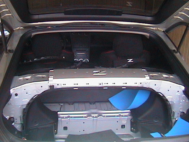

Another pic to show where I placed some foam padding the I got at an arts suppy store for 59 cents.
