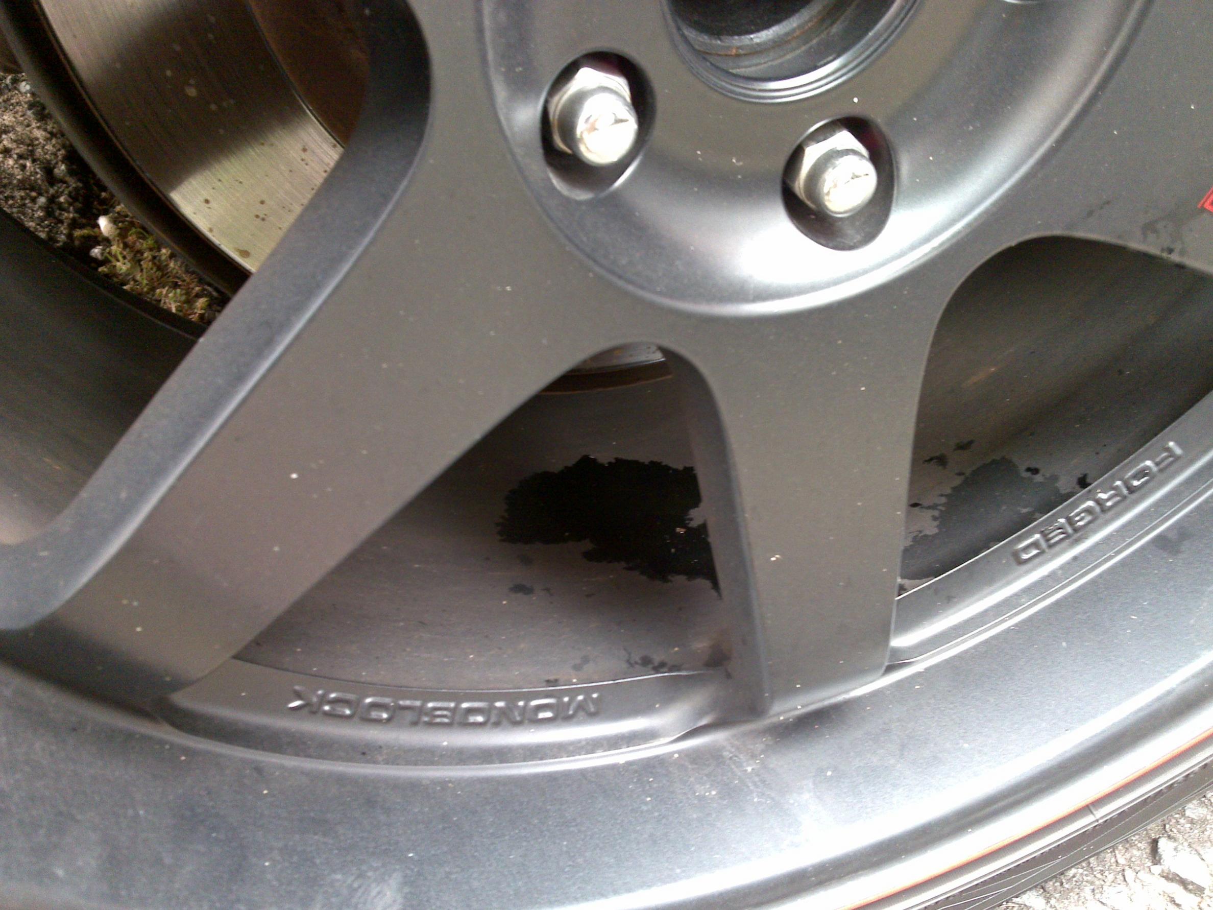

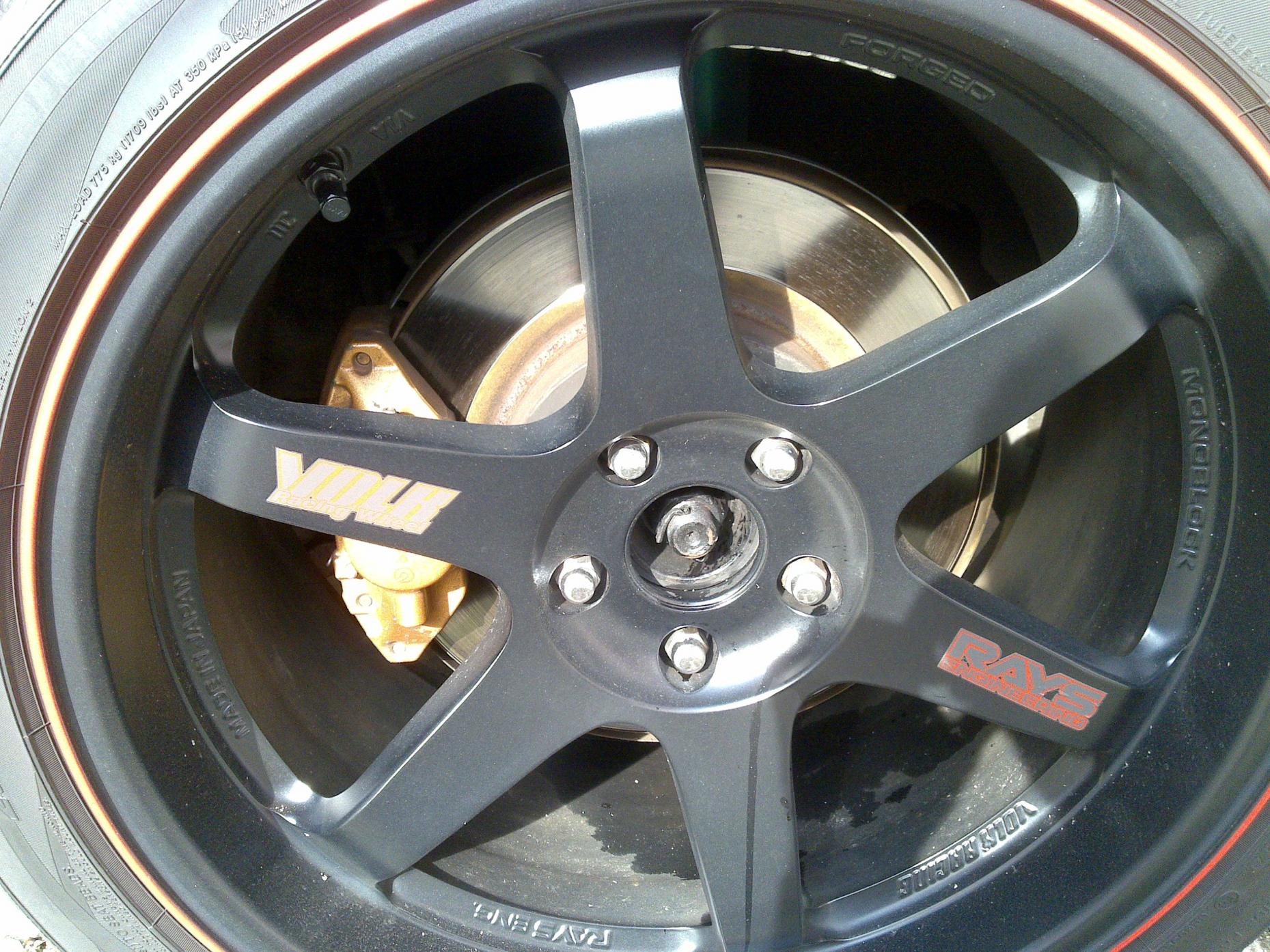

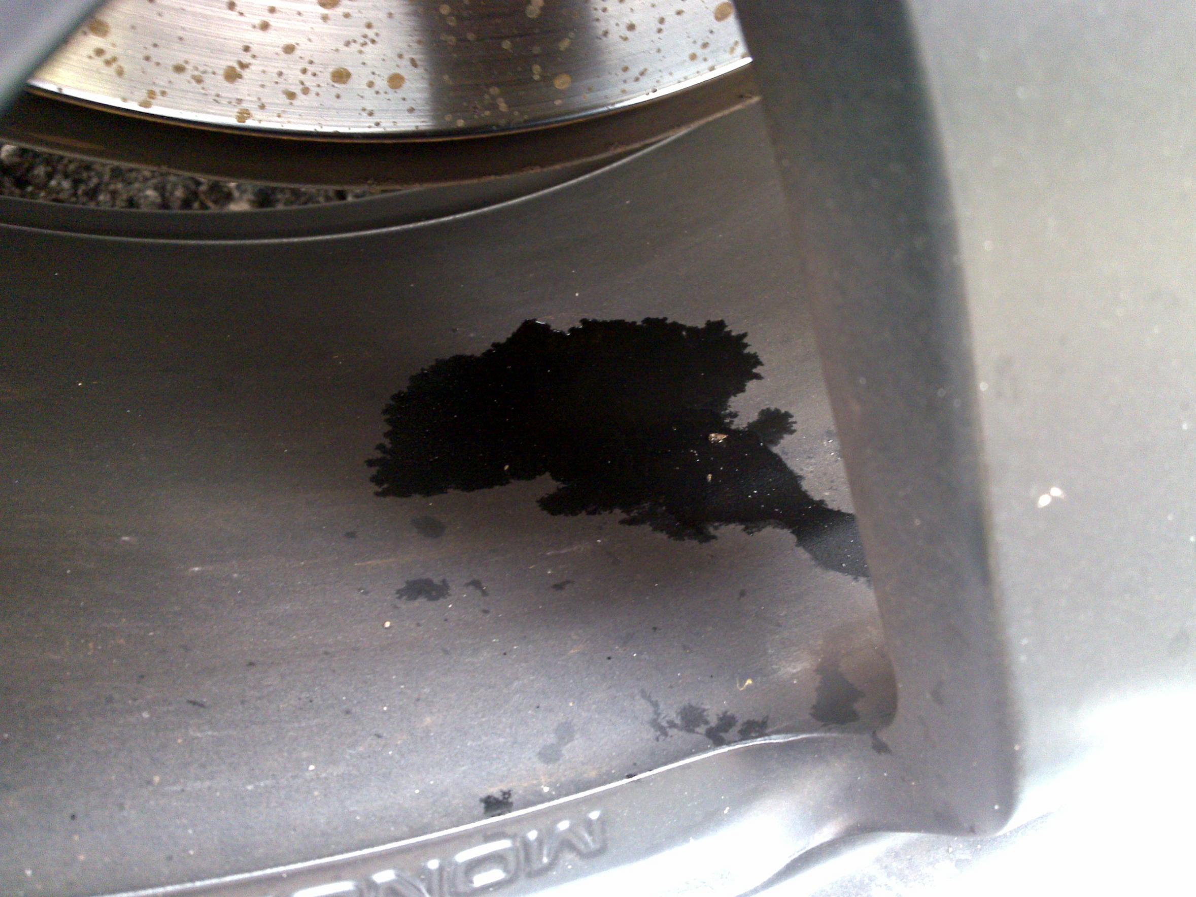

I have noticed intermittent oil leak staining my rims. I suspect they are leaked from the calipers.
Anyone think otherwise, could they be from the suspension???
I am planning to buy a service kit for the brake kit and have the seals replaced. That should fix the problem?
Anyway, these pics are 2 different wheels and taken on different day.
Attached Thumbnails Oil stain. Are they from brake or suspension?-03072009191.jpg   Oil stain. Are they from brake or suspension?-09052009171.jpg   Oil stain. Are they from brake or suspension?-09052009172.jpg

That is an unusual leak. Assume it is the brake line to calliper connection.

Dude, just take the wheel off and try to find where it's coming from

It's got to be brake fluid. There's nothing else that can leak there.
YUP! touch it, smell it, lick it, but its most likely a small slow brake fluid leak.....seals..
Usually when coilover shocks blow, its a black powder substance..
BINGO!

+1
Make note of your fluid level in the reservoir also. Check it periodically to see if it drops...
