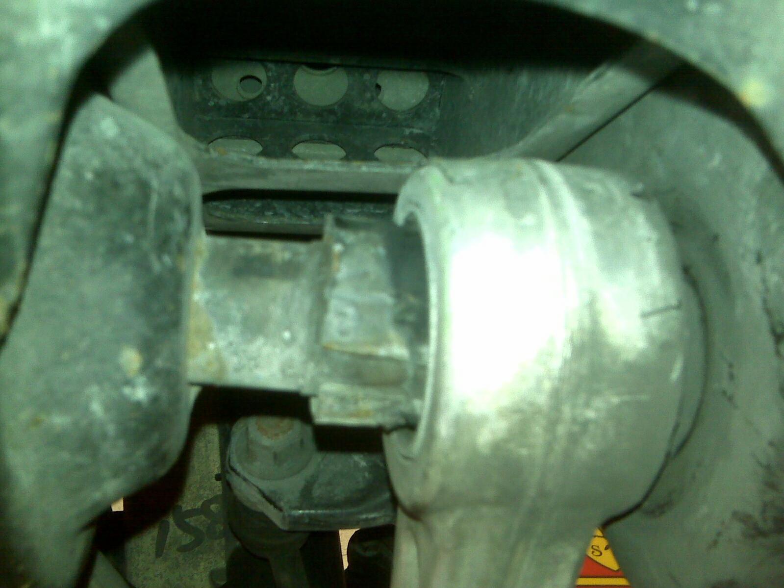

Ok so its bad but not to the wallet thank goodness. Apparently my initial assumptions were right in that it was suspension related. The control arm for the drivers side is bent and twisted. It is knocking against the bushings and such to make the noise (friction from stopping). Part is overnighted and goes on tomorrow. This was apparently the result of an improper removal of lowering equipment. A previous owner had beat the spindle/control arm to drop the bushing out and remove the lowering hardware, however all they needed to do was separate it with a fork like tool. The evidence of this is the hammer marks and a small tear in the spindle where grease is slowly leaking out.
I figure it went like this: upon sale of the car to the kid I bought it from, the owner wanted to take his springs back, so he tried to take them off and forgot or F@#$ed it up and needed a hammer. The suspension is actually fine, its just the arm and spindle that are beaten to hell. To give you an example, the whole front left assembly could be manipulated in such a way that the tire moved almost 3/4ths of an inch forward. Curious because I had no serious alignment issues outside the noise.
I'll post pictures because it'd kind of entertaining, after I upload them. Hope this helps someone in the future.

The first pic is the whole bad arm. It's actually twisted, as if you tried to twist an arm or open a door; and also bent at the bushing.

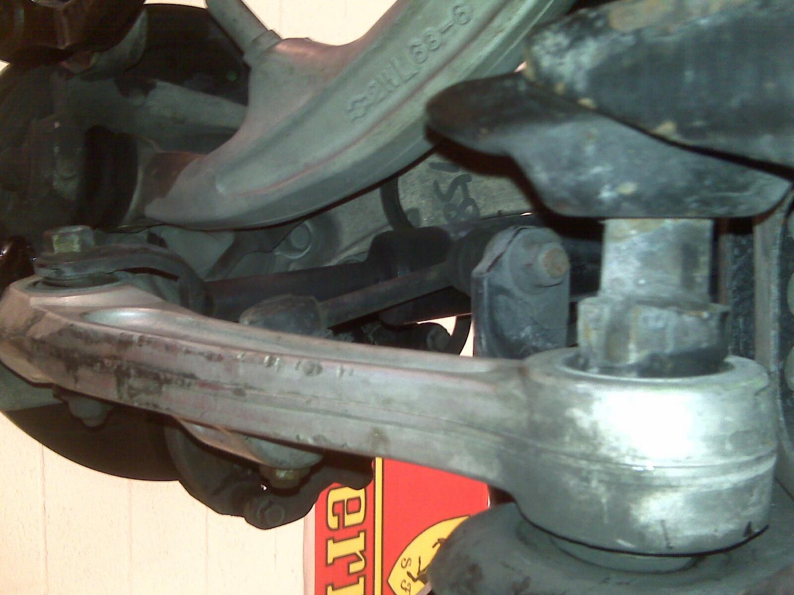

The second pic is what a GOOD control arm looks like.

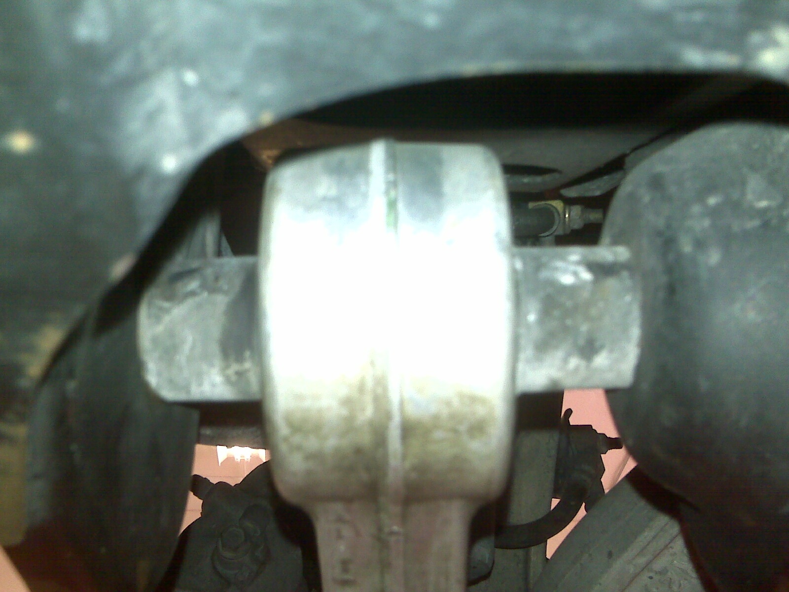

The third pic is the BAD control arm. The arm would slide as I described.

That will cause the problems , and should have been noticed by the mechanic when he check out the front end.
