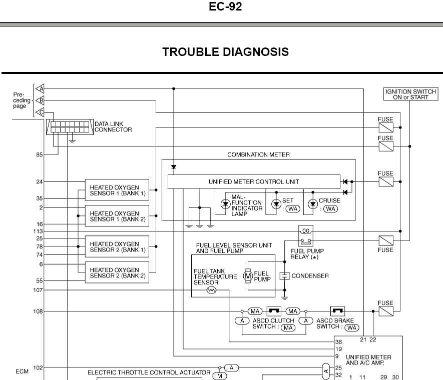

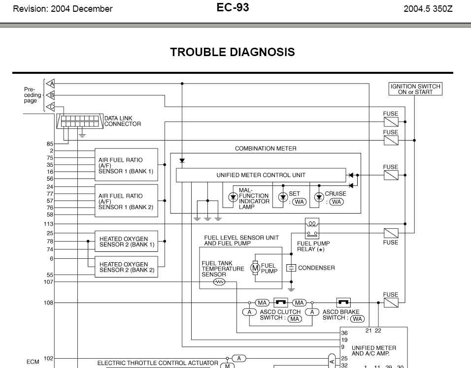

Check out the Courtesy website CLICK. There are 26 different ECUs listed for the 350, varying by year, model, transmission.
BTW - there's no way that I'm aware of to tell by the engine serial number if it's a 2004 or 2004.5. If you have the VIN number of the car it came from, we can tell from that.
Here ya' go - look at the differences in the pin-outs of the 2004 vs the 2004.5 ECU.
Attached Thumbnails Help diagnose the problem... Thanks :)-2004ecu.jpg   Help diagnose the problem... Thanks :)-2004.5ecu.jpg

Originally Posted by DavesZ#3
The rev-ups didn't start until 2005 on the Anniv cars.
ah, i get backwards on that stuff. widebands and ecu change then 05 was the engine change. my bad
