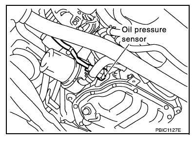

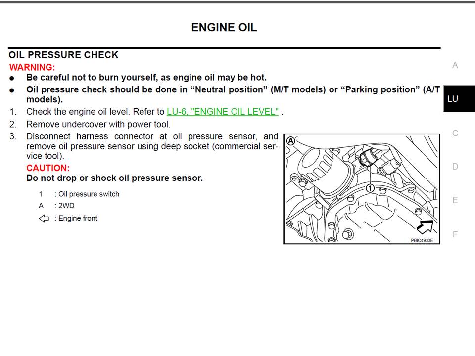

Here is the location of the pressure sensor. In the picture it is the one with the black connector.
