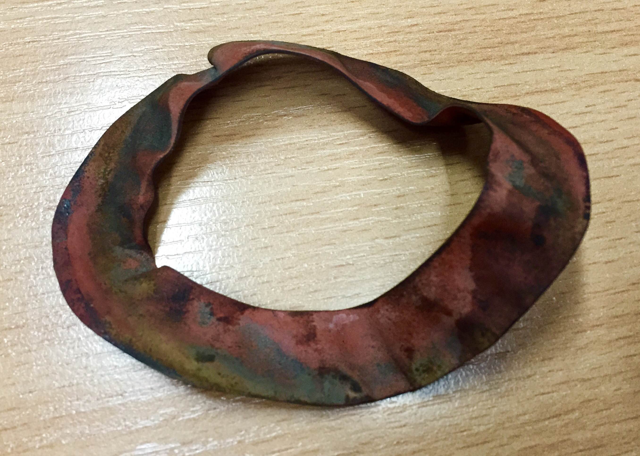

by the way, thats how the OEM gasket looked like:
