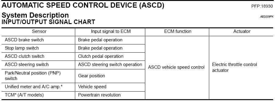

Here's all the things that affect Cruise (ASCD)

Thanks for all the help guys! Turns out the clutch switch just needed to be adjusted a little more. Another turn and a half and everythings working fine now!
