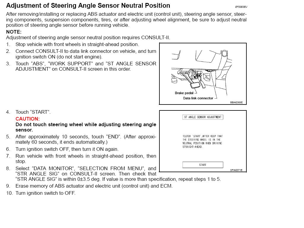

Exclamation SLIP / TCS light comes on (solved) and ignition problem
Hi all,,
I have 2 problems
1st: ((SOLVED))
The SLIP / TCS light comes on the moment I start driving / rolling the car out of the driveway.
Sometime I can feel the slip / tcs kick in like crazy! (similar to abs kicking in).
Sometime only the lights comes on with no sign of it kicking in.
After both lights come on I can't switch on/off the TCS
and (TCS off) light remains on till I restart th car
Solution: I have checked the car using Consult II and C1143 Code appeared
its for ((Steering Angle Sensor))
and all I needed is reset the steering angel using Consult II (steps are attached))

1st: ((SOLVED))
