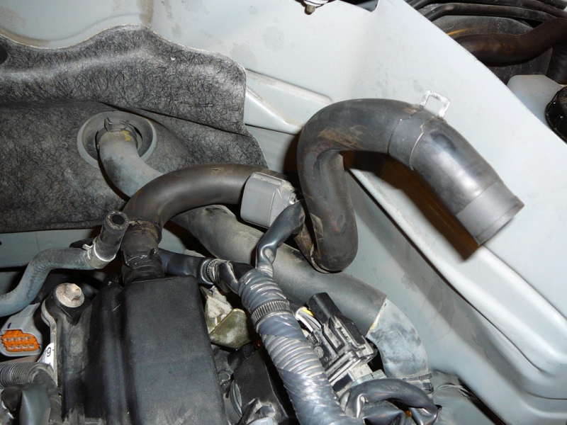

I didn't see this before I took the manifold off but the hose that runs from the Rocker Cover to just upstream of the TB has oil on and around it at the connection to the rocker cover. So this could be 60000 miles of build up or a weeks worth of troubleshooting. I just wiped it off so the picture doesn't show the buildup. It wasn't very much but it was still liquid.
Edit: Now that I think about it there was oil buildup on the TB the very first time I took the intake off. So I'd guess that was 60000 miles worth of buildup.

Oh that was deliberate. That Gray/Orange plug in the bottom left of the photo is the fuel injector harness. The gray plug in the center is for the TB. Everything else is plugged in tight in the photo. Perhaps it's just the angle of the shot.
Was just to give reference point. When mine went bad the car first randomly stalled with no one in it(on Autox grid; confusing!), then took 2x cranking time with louder exhaust and misfire codes; eventually set CMP related code.
