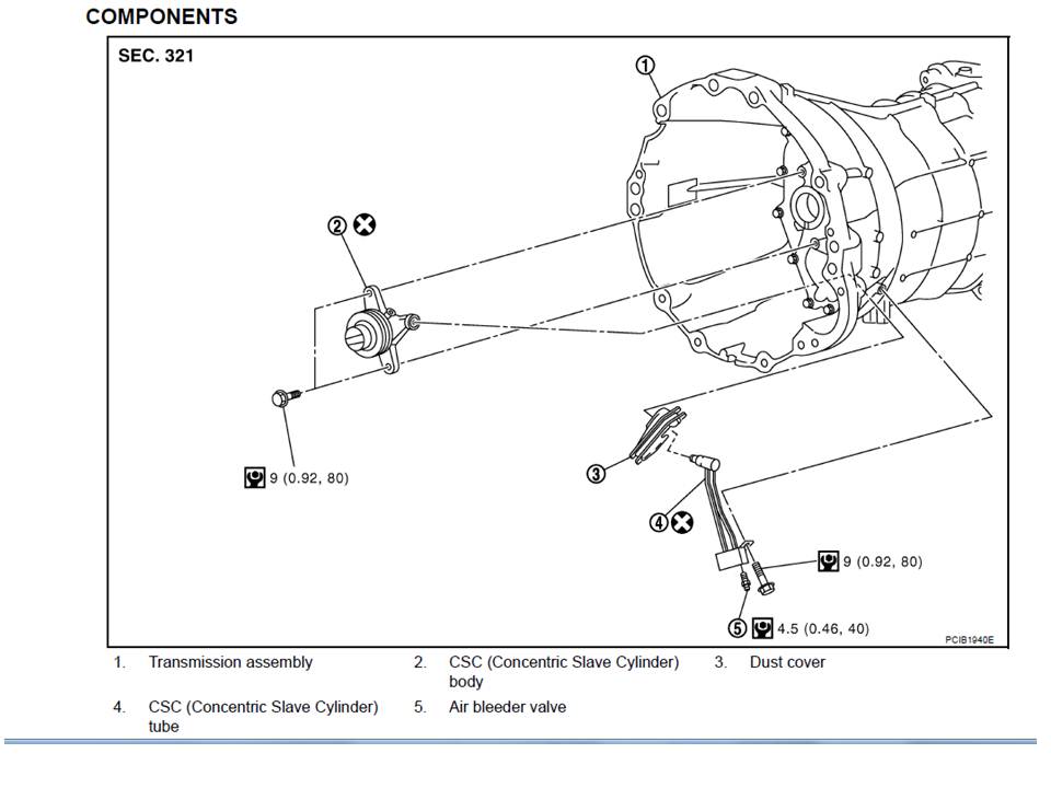

Originally Posted by laurentj23
The location to bleed the the clutch.
Its the bleeder screw on the bell housing...why would you need a picture of that?
Regardless, here is a pic to give you an idea:
[picture]http://www.carbonetic.net/blog/blog/wp-content/uploads/2007/03/resize0014.jpg[/picture]
The only difference with mind is that i have a hydraulic throw out bearing instead of a slave and clutch fork.. So where the clutch fork is coming out of the transmission in the picture i have 2 hydraulic lines (one being from the master and one coming out of the bell housing as the bleeder line.

laurentj23 - here is a pic from the shop manual. The bleed location is similar for the heavy duty CSC.
Installed HD CSC and now clutch wont bleed! help!!-service-manual-clutch-pic.jpg
Old Dec 15, 2011 | 11:52 AM
Junkster's Avatar
Junkster
Joined: Oct 2010
Posts: 4,587
Likes: 18
From: Sacramento
Attachment 329225
Its actually identical with the exception that the stock hard line is replaced with a SS line...other than that there is no difference.
