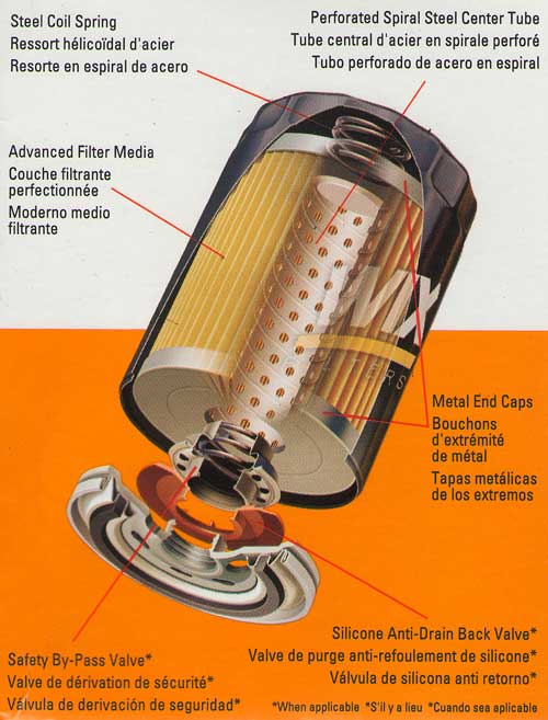

Do I sense sarcasm and skepticism?
Are you basing your opinion on the WIX filter on XX amount of hours of research, or on a wimb?
What exactly do you know about this particular filter?
Here's a breakdown image of the WIX filter

FYI: AMSOIL trusts WIX filters enough that they sell them on their site.
http://www.amsoil.com/a/nanofiber-synthetic-oil-filter
Here's the description of the WIX filter from the AMSOIL website:
Made with a full metal base plate for superior strength at the double seal & also feature a silicone anti-drainback valve. Glass-enhanced media in WIX oil filters offers greater efficiency, capturing more 10 to 12 micron sized particles than other cellulose/synthetic blend medias.

If they are that good then why are they not promoted and used heavily?
what does amsoil carrying them have anything to do with their quality? If anything they would probably choose NOT to support a product that they find superior to their own.
and of course their quote to capturing more than any other brand was done in house and tested by their own paid researchers. Any of the independent studies tested them against other filters like all the other major brands have been tested? I'd like to see an unbiased report against the major competitors just to make sure that there isn't a little bit of "advertising adjustments" made in that claim.....cause we all know that never happens.
edit: it has been tested:
"Instead of the leaf spring spacer that most filters use, these use a stiff coil spring at the top of the cartridge. The only drawback to this design is that the bypass valve seats metal-to-metal against the bottom cartridge end plate. This could allow dirty oil to seep from the dirty side to the clean side of the filter, bypassing the element."
http://minimopar.knizefamily.net/oil...rence.html#wix
also, it's nitrile rubber, not silicone for the anti-drainback valve when they tested it.
bosch are noted to have a silicone seal but it also lists nitrile. Either way it doesn't matter for the amount of time they are in the car i just wanted to be clear that their advertisement of silicone isn't quite accurate when it was cut open and tested.
He does list the WIX/dana filter as a recommended filter on his site though.
