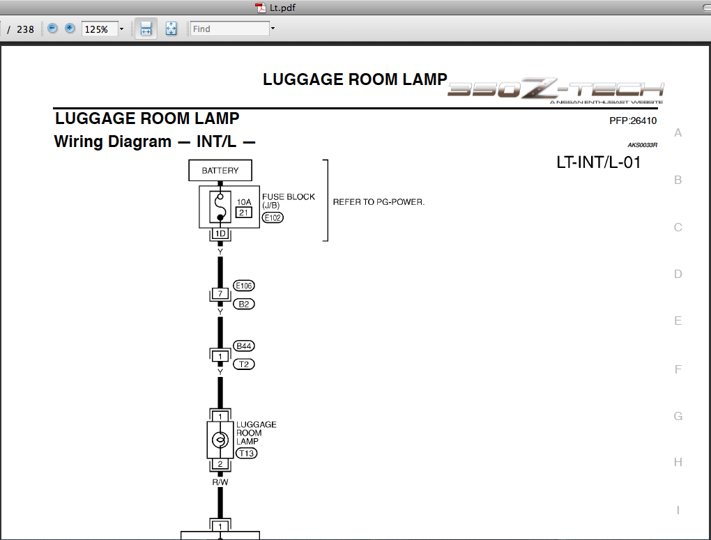

Took out the trunk leds from trunk connection and now they dont want to work.
Leds work fine since they work on the license plate connectors
So I know its most likely a fuse.
Most likely its the fuse box behind battery
Does anyone know whats the fuse number for trunk light

Here you go. You can find the service manuals on wiki. Hopefully that's your problem and nothing else.
Thank you man.
Your help is recognized. Hopefully the fuse is the problem.
