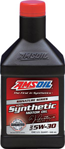

Now I dont think Id ever go 25k but this is from the signature series oil:
SERVICE LIFE
AMSOIL Signature Series Synthetic Motor Oil is recommended for extended drain intervals in unmodified(1), mechanically sound(2) gasoline-fueled vehicles as follows:
• Normal Service(3) – Up to 25,000 miles or one year, whichever comes first.
• Severe Service(4) – Up to 15,000 miles or one year, whichever comes first.
• In all non-gasoline-fueled vehicle applications, extend the oil change interval according to oil analysis or follow the OEM* drain interval.
Attached Thumbnails 10k Oil change intervals?? Amsoil XL-amsoil-sig-series.jpg
