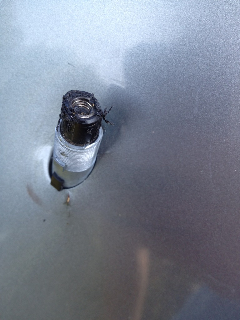

I took the base off and am now left with half of the screw still stuck.
Here's a picture:
https://mail-attachment.googleuserco...DPazo&sadssc=1

Seems now that you have the base off,the screw/bolt could be removed
per my drill idea?You could now clamp it in a vise or Workmate?

I tried you're idead, but it didn't work.
See if this picture works:
http://i933.photobucket.com/albums/a...ones/photo.jpg

Dammn, that sux...im guessing the plastic base was adheared to the metal section..
your best bet is probably a junk yard..or try www.slidegood.com and just get a new assembly.
