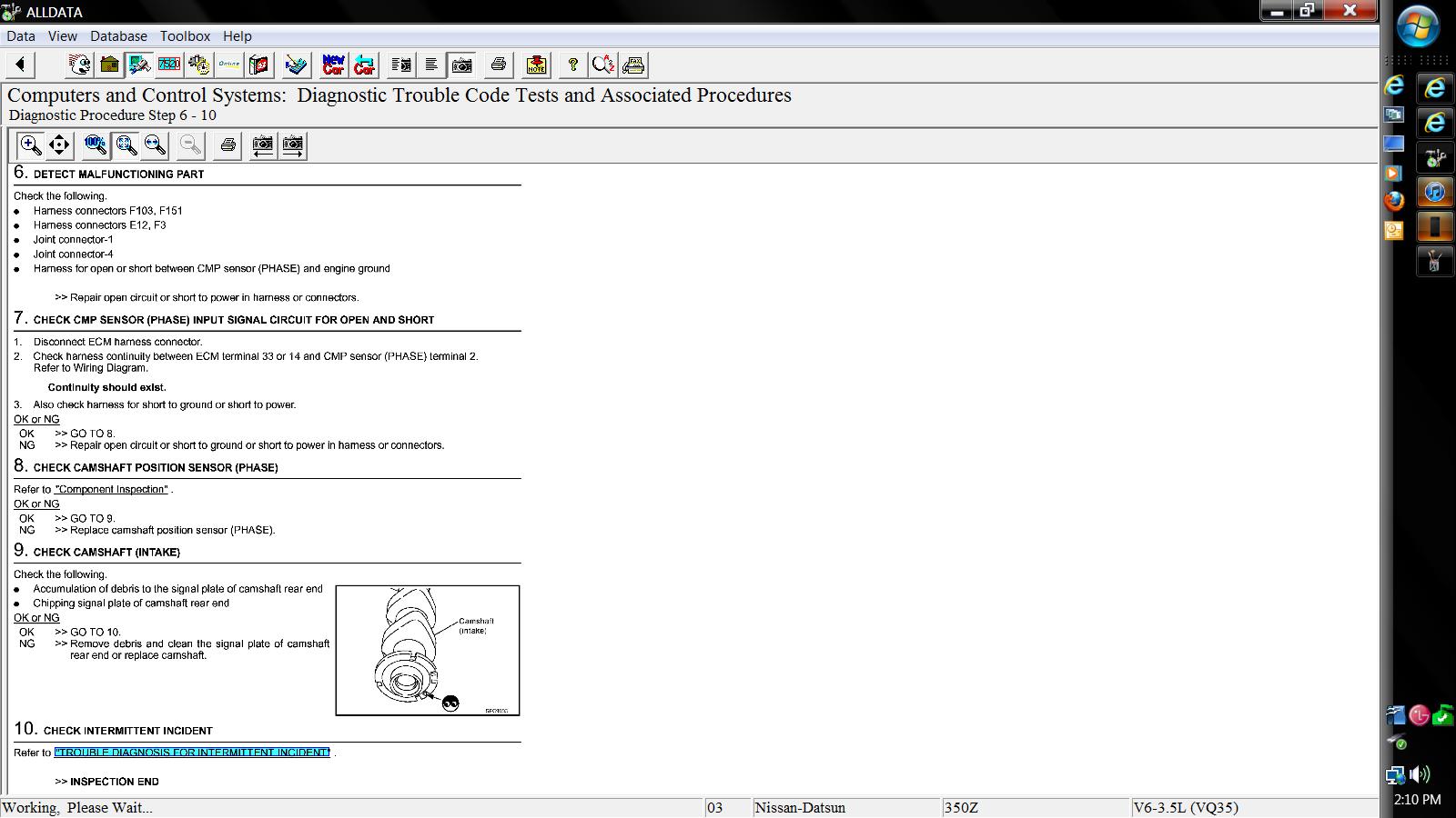

I don't think the sensors are bad. To test the sensors there is a functional test I can get you if you want it. Motor mounts would most likely not be the problem, possibly if they were totally gone. Think logically, something that causes problems on multiple sensors on an engine that has been re-engineered and installed by incompetent mechanics is most likely engine mechanical problem. Have I mentioned yet that I am Master Tech? I keep forgetting tell people that so they listen.
The sensors use a magnet to "see" the gaps on the ring on the end of the camshafts, the crankshaft uses the flywheel. These gaps give a voltage signal to the ECM, it should be _-_-_, on off in a square wave pattern. If there is debris in the oil it will mess with the gaps.
Old Jul 28, 2012 | 01:06 PM
Neimad's Avatar
Neimad
Posts: 573
From: Oakland
Old Jul 28, 2012 | 01:08 PM
Neimad's Avatar
Neimad
Posts: 573
From: Oakland
