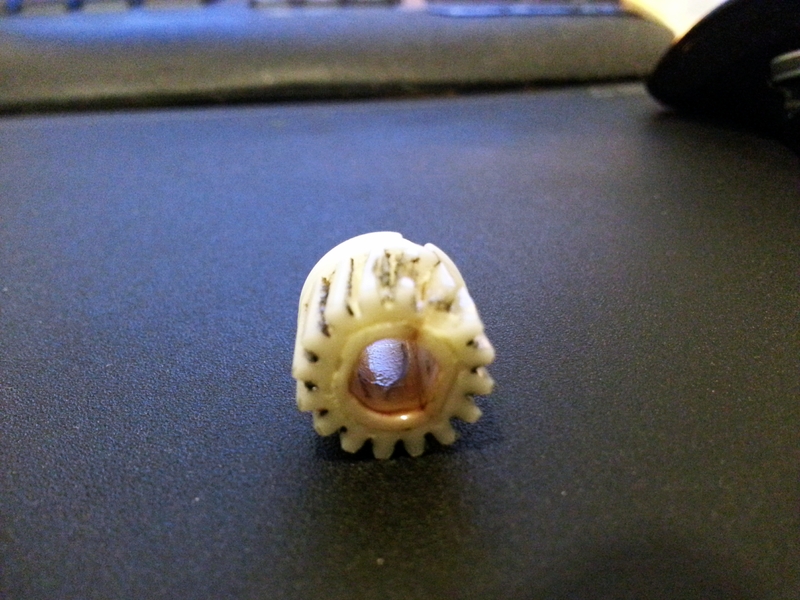

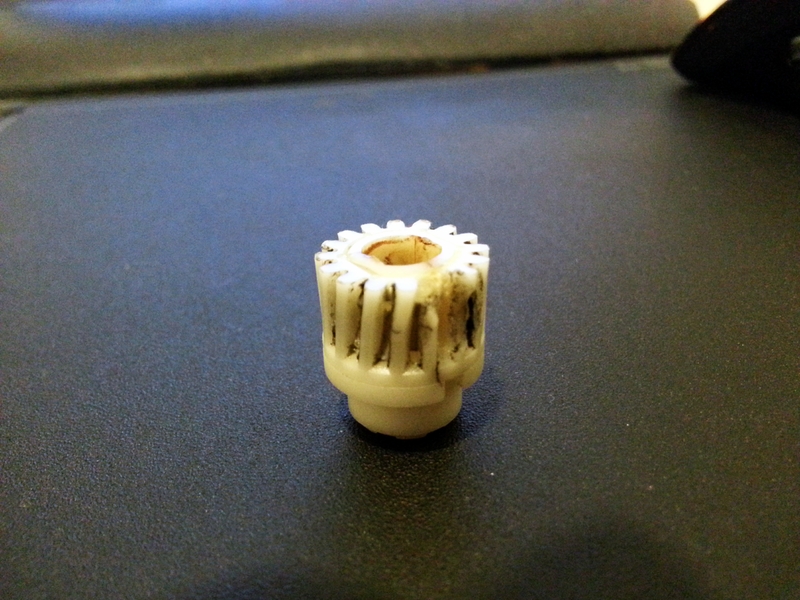

Hi guys, a very happy new year to everyone.
My passenger seats died on me just before Christmas last year and I found out the reason for it was the damaged gear? from overheating or something. It looks to me like part of it is melted.
According to my mechanic the whole electrical component is still functioning and it is this gear that prevents my seats from moving forward or backwards. Can someone be kind enough to help me identify this component so I can purchase them?
I brought it back to the Nissan dealer and the refused to sell me only the replacement for the broken gear, and insist that it has to come together with the whole electrical board/ system and it will cost me about USD2000 after conversion. No way I'm paying for it...
Appreciate if anyone can help me out with it.
Attached Thumbnails Need Help to Identify part on passenger electric seats...-c36020130102205754.jpg   Need Help to Identify part on passenger electric seats...-c36020130102205852.jpg

Problem is I need to find the exact part number. I have a friend who can order any part but he needs the specific part number. I wass hoping someone here will know...

Have a friend with a g35 coupe his did the same thing. Was told the same thing at the dealer. He found a speedo gear supplier that provided the gear he needed, I will reach out to him and try to get the name of the source. Less than 10 bucks for the gear, I think. Well just heard from my friend, try a company called "odometer" was mistaken about price though $65.00, still better than new motor. odometer.com

Latest update, finally got my gear from said website. Replaced by my mechanic and seats working perfect now. Thanks for the help.
