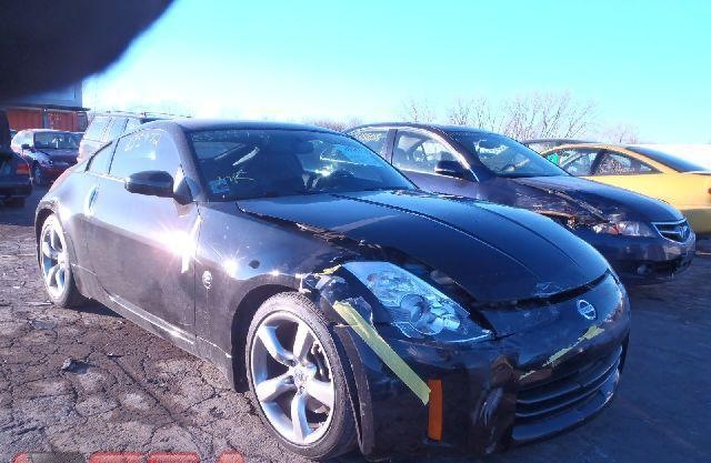

Just purchased a 2006 Z, listed to have 10k (lets hope its legit) actual miles from insurance with what appears to be minor front damage and was wondering if anyone has replaced the radiator core support? Any crazy obstacles to watch out for when replacing?
Any recommended places to purchase parts?
Any info much appreciated

Take a real close look at it in person - notice that the battery cover doesn't sit right. Could just be the fender shifted, or the frame could be tweaked a little.
Don't be suprised if that seemingly little damage winds up to be a few thousand - my dd looked better than that yet cost $4500 to fix.

Looks like a good buy for $5800. My '08 had quite a bit less visible damage from a minor front side-swipe impact last Fall, and the bill was ~$7K. Much of it was the airbag/seatbelt stuff, though. Basically, the bumper cover got ripped off and the core support had a tiny crack, but unfortunately the airbag sensor just barely got tapped and the driver's bag blew and both seatbelts retracted and locked - car wasn't even moving. Even both the fenders and headlights were undamaged, so it really did look like a very minor impact.

I wouldn't put all my bets on a battery cover and surrounding - its all plastic. it looks like its not put back right. damage looks pretty minor.. air bags didnt even go off. doubt there's any frame damage then.
core support is pretty simple. if i remember correctly you can remove and reinstall it with the radiator and fans attached.

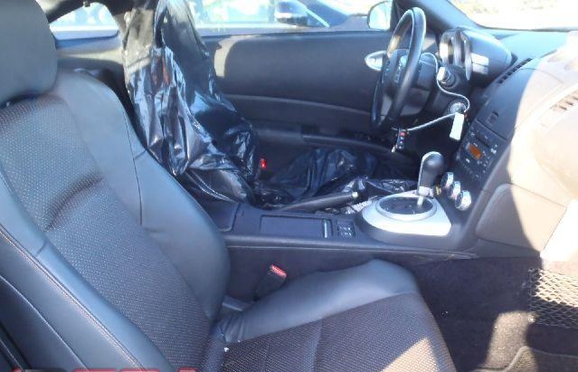

I tend to lean towards light damage as Voboy pointed out the bags did not pop which tells me it probably was not to bad. Auction folks probably had the battery cover off to jump but still the possibility is there...my experience has always been that there is always more damage than you think so bid appropriately. Still trying to figure out why the driver seat is covered???

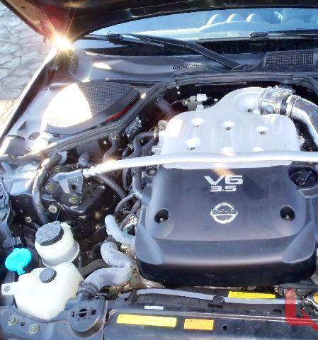

Awesome find! I just completed a motor swap on my '04 w/ 209K miles for a lower mileage unit. In the process of doing the swap I removed the core support and I was surprised how easy it was. Not necessarily straight forward since you have the radiator, a/c condenser, power steering cooler, windshield wiper fluid reservoir, and electrical harness attached. It may seem tedious but not complicated. Just have zip ties handy to help hang/support components (i.e. a/c condenser). The part that held me up was the disconnecting the lines to/from the power steering cooler. Make sure you have something to catch the fluid, I used a cheep-o plastic bucket.
When I removed the core support, I still had the headlights and the subframe on (the part attaching the core support to the upper wheel well structure). I'm not sure if my approach would be ideal for you since you are replacing the core support and I was just trying to remove it as a much as a modular unit...
