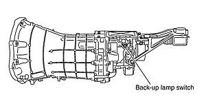

Thank you for your reply, i tried the continuity test for the fuses, all worked, bulbs are new, and measured the voltage where the bulbs go and nothing, where's the tranny switch?

https://my350z.com/forum/maintenance...ht-switch.html

You can see the blue connector on it below the second bolt from the rear on that black plate on top.

Unhook the connector from it, check it for power. If you're getting power to it, use a paperclip or something to jump across both terminals and that should turn your lights on.
