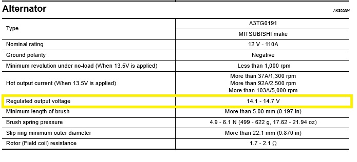

I've always wondered the same, My start up voltage is 14.4V when the car is cold, Then it starts to drop as the car warms up. Some times it gets down to 13.4 in hot days. and if i re-started the car, it will stay low.
From the FSM it should be between 14.1 to 14.7 volts.

Mine can get as low as 12v.
