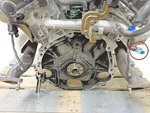

The knock sensor is placed under the intake runners, You have to remove the upper and lower intake manifold then the runners to get access to the sensor. It's an easy job if you know what you are doing.
The harness is a part of the injectors harness, But Z1 sells the sub harness only.

Here's a pic showing the other end of the KS harness,
Something seriously wrong please help :(-h9dhqqd.jpg
I actually have the entire electrical kit for the car I needed cuz I needed part of the mad sensor harness, it's used off a other Z my mechanic got them. But the injector harness and everything is sitting in there, should I give it a try or just buy a new sub harness?
Also thanks for the detailed response man!

Considering that reaching the sensor is a time consuming job, I would just buy a new harness.
