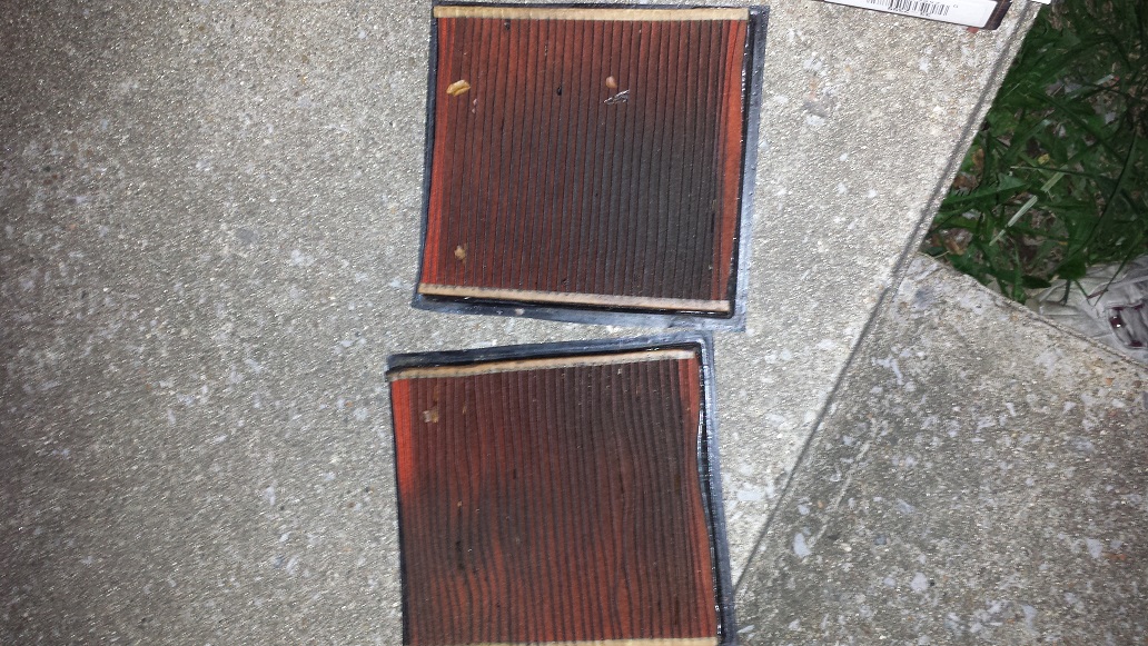

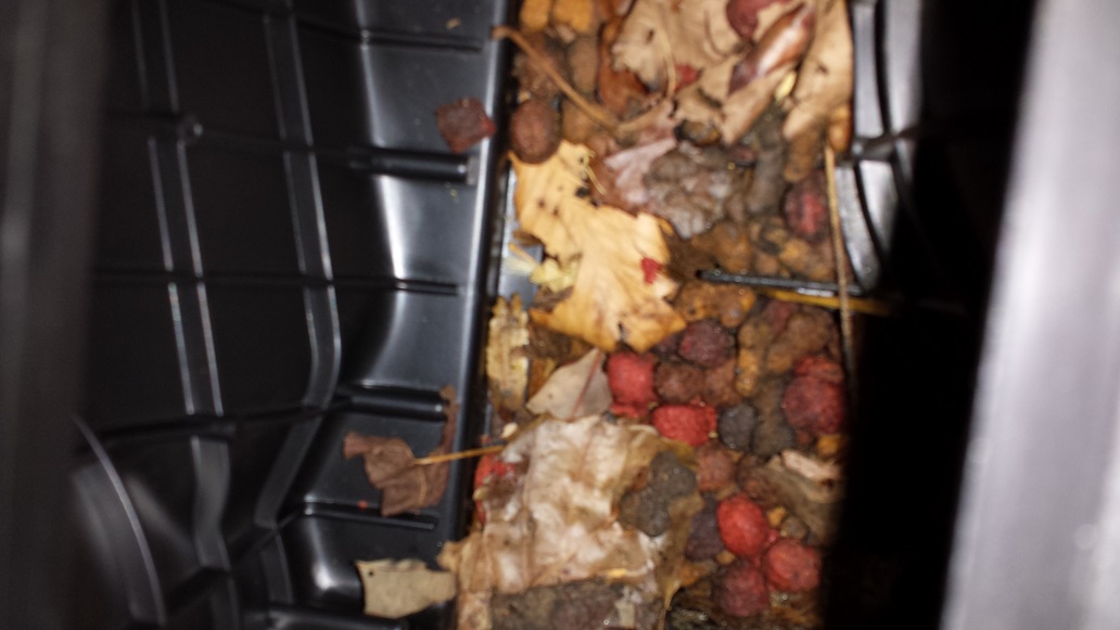

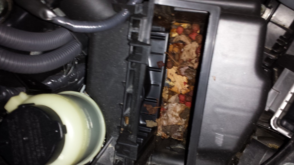

Zak and oldschool were right on the money. Just bought the car figured i could rule out air filter/maf well thats BS, 125 point inspection my rear end. was completely black and there was leaves and dog food! yes dog food. DOG FOOD. I am going to have it out with the dealer in the morning. Pics just to show you the absurdity. I can understand the leaves. The dog food? In both Boxes? What other "points" did they miss?
LOL! That has got to be one of the funniest things I have seen causing engine problems - dog food! Man, someone pulled one over on you!

Well I figure it was a mouse or something from the previous owner. It looks like it had been in there awhile.

You should tell the guy who sold you the car to eat the dog food for claiming it was inspected. You should at least complain to the Attorney General in your state and to the BBB to let them know that the dealership is making false claims about performing inspections on used cars.
