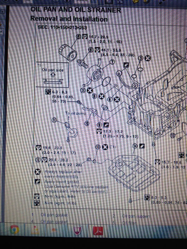

My g35 had a leak from behind the oil cooler. It start as little drips then gets worse. This is also a prob with meranos. Anyways the gasket is cheap from Nissan and it's easy but you will have to change oil again.
Its the o ring behind the oil cooler behind the oil filter

No it's just like doing a oil filter, just rub some new oil on the gasket. I can't find the part # but the new one is black and didn't seem to fit as nice as the old orange one but it is the updated part and it worked. Use the pic in the first reply to get your torque specs.

From the picture - is everyone sure that bolt number 6 is properly torqued to specification? Its an easy bolt to loosen without knowing it.
