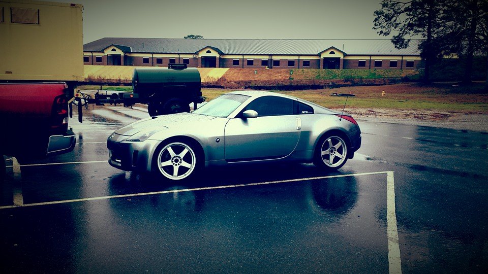

I bought my first Z in the middle of February, 2003 Z33 Base with 113xxx miles. Has LSD axle swap, light weight flywheel "brand unknown", Injen CAI, header back Greddy exhaust, and 19" Ray's wheels. I went to Import Alliance last weekend; I bought and installed a Kenetix intake manifold. Thats all on performance.. for now... On the way home from IA, I hear a loud knocking soon as I get back on base "Ft Benning GA" and when I get to the 1st stop light, she stalls. with it knocking and stalling everytime I press the clutch in, I park it in the closest parking lot and wait for a tow truck.
I hit up onw of my friends and he pulled a code on his scanner P0011 Intake Camshaft Position Timing Over Advanced. THinking it was the chain being really loose from a failed chain tensioner, I tried not to sweat it and let the truck tow me to the dealership, only garage that I know that works on Z's in my area.
Few days later I get a call saying its the Main Bearing, they wont pull my engine appart and rebuild the short block, Id have to buy a New engine and have them install it for $7000 ish..Yesterday I called Z1 Motorsports and asked if they had a used stock engine.. They did with 73K on it for $3500, theyd ship it to me for a total of $4k.. I have a Auto Skill Center at my use with unlimited tools, lifts, ect... Today, im going to drive my Z back on base and park her in the lot outside my barracks, and try to get a AER Loan and get this car back on the road within the next 2 weeks.
The previous owner ran the **** out of this car I bet, This Z will have a way better life now. If anyone has any suggestions, let me know, I never did a swap before. Learning EXP.
