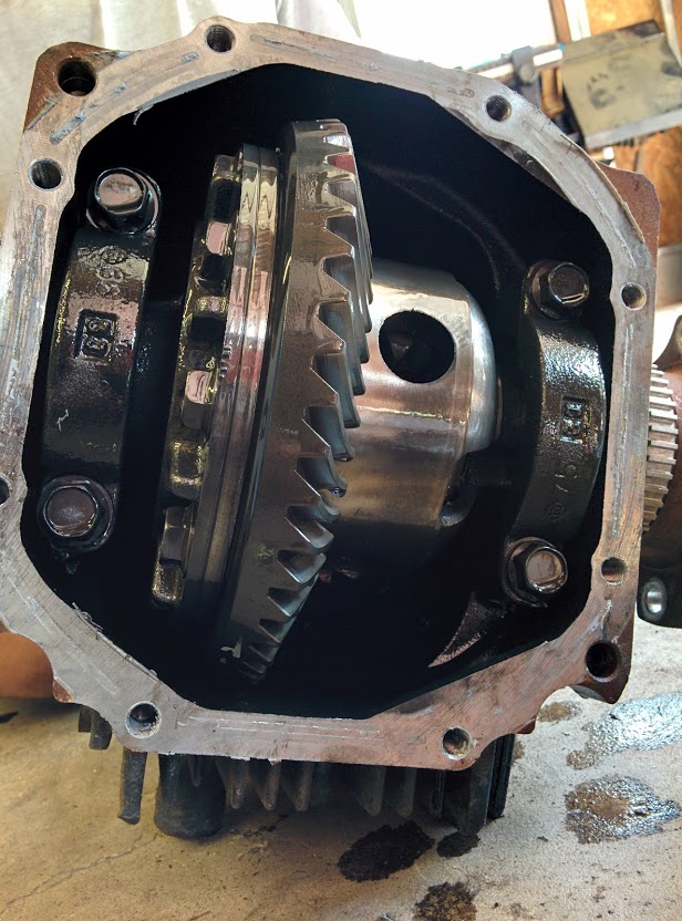

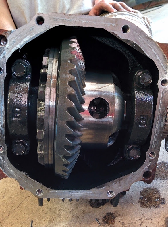

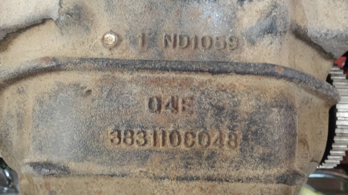

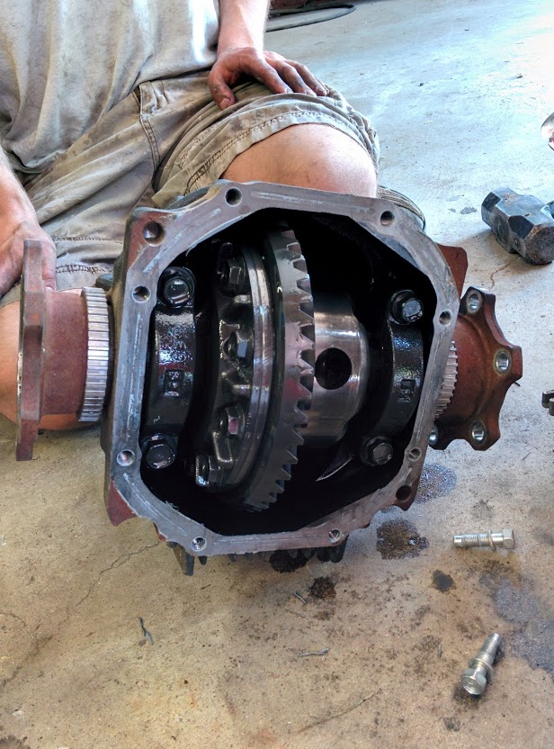

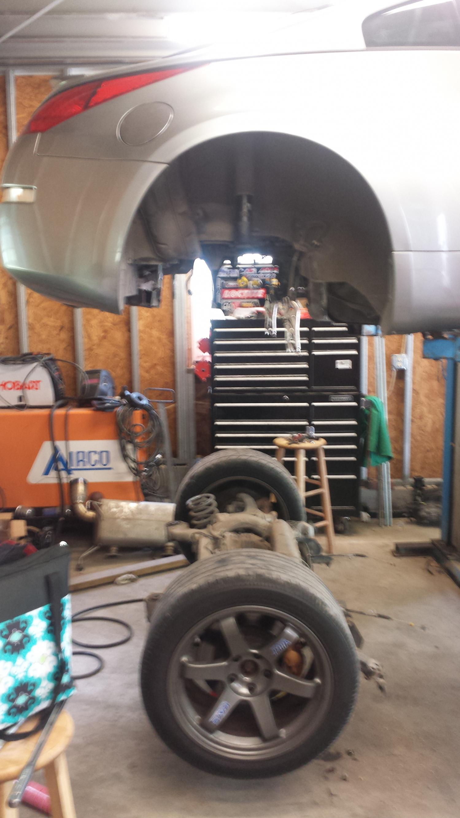

Update!
Dropped the rear subframe to check out what's going on back there. All of the bushings were intact and had the appropriate amount of movement. We decided to swap in the urethane subframe and solid front diff bushings while it was down. Post swap, 97% of the clunk is gone (my guess is the 3% is sway bar). I'll call that a success.
I'm still a bit perplexed as to what the clunking was with all good bushings. I've read about the diff springboarding with a solid rear and stock fronts, but that'd have to be a lot of movement to make the clunking I heard.
Below are some pics of the diff. Google pulls up a lot of foreign links for that part number so it appears to be from another region. If someone is able to run a part number through Nissan that might help.
