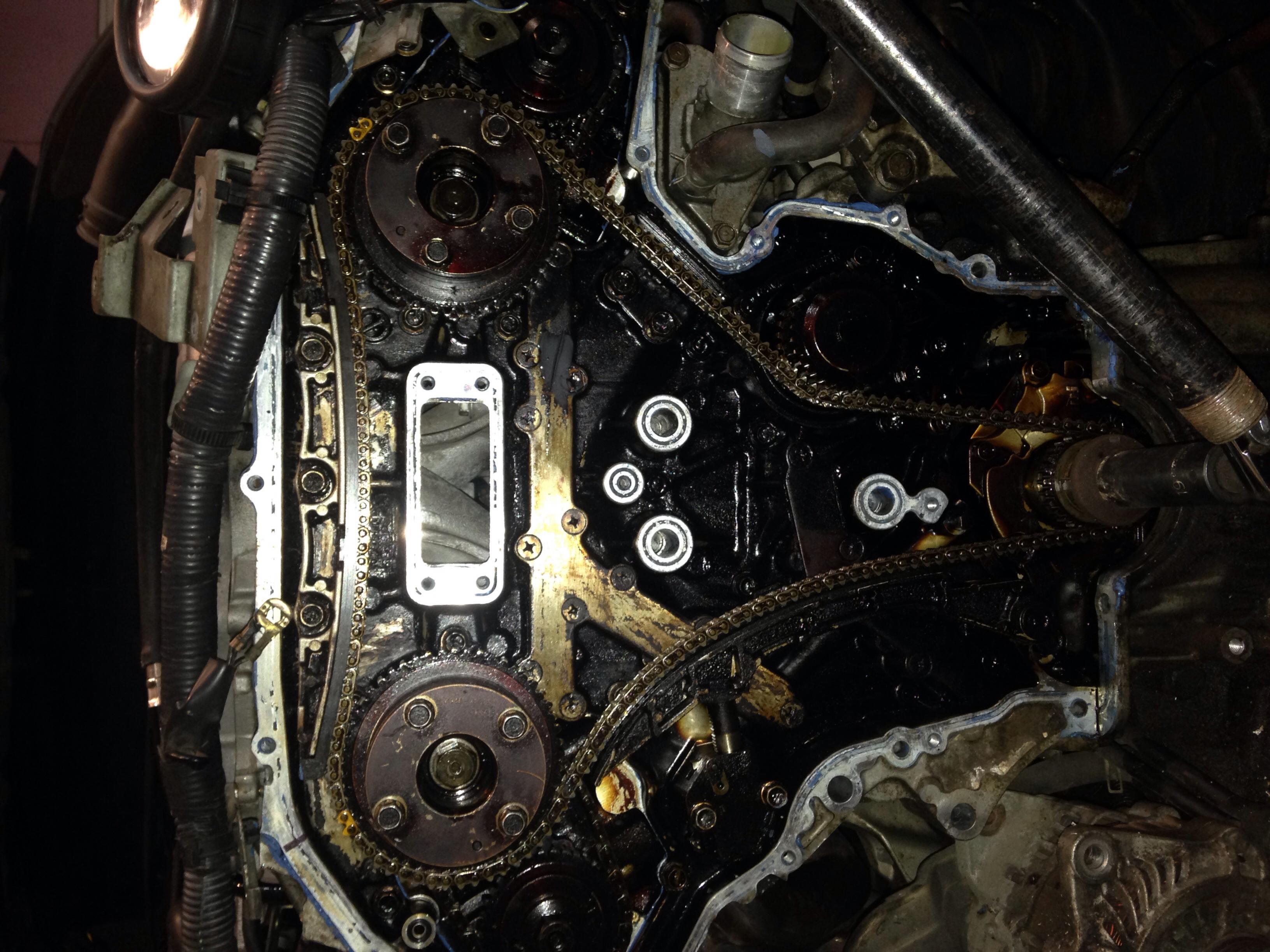

Alright so I'm just trying to narrow down the possible faults here. Can anyone tell me if my timing is right? I have some pictures to go with this, to check my timing I hooked up a vacuum/pressure guage to cylinder one and cranked over the engine with a ratchet. The guage showed compression building up as the 3 marks on the sprockets lined up, and the guage stopped reading pressure right where I left everything in the pictures, meaning it's at TDC. Does that seem correct to you guys? Just so I don't put it back together and find out the timing was the case...

Timing chain

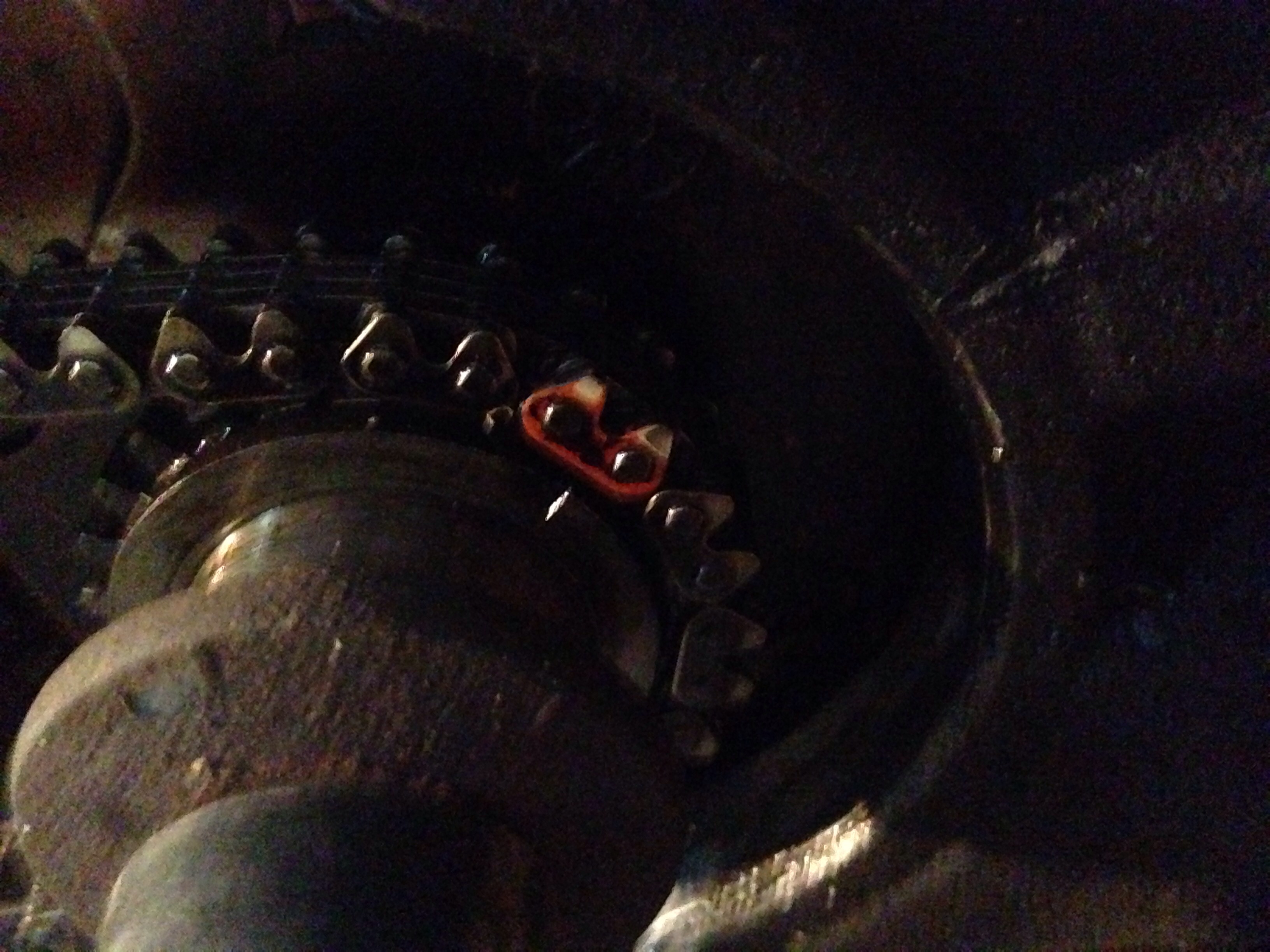

Timing mark-crankshaft

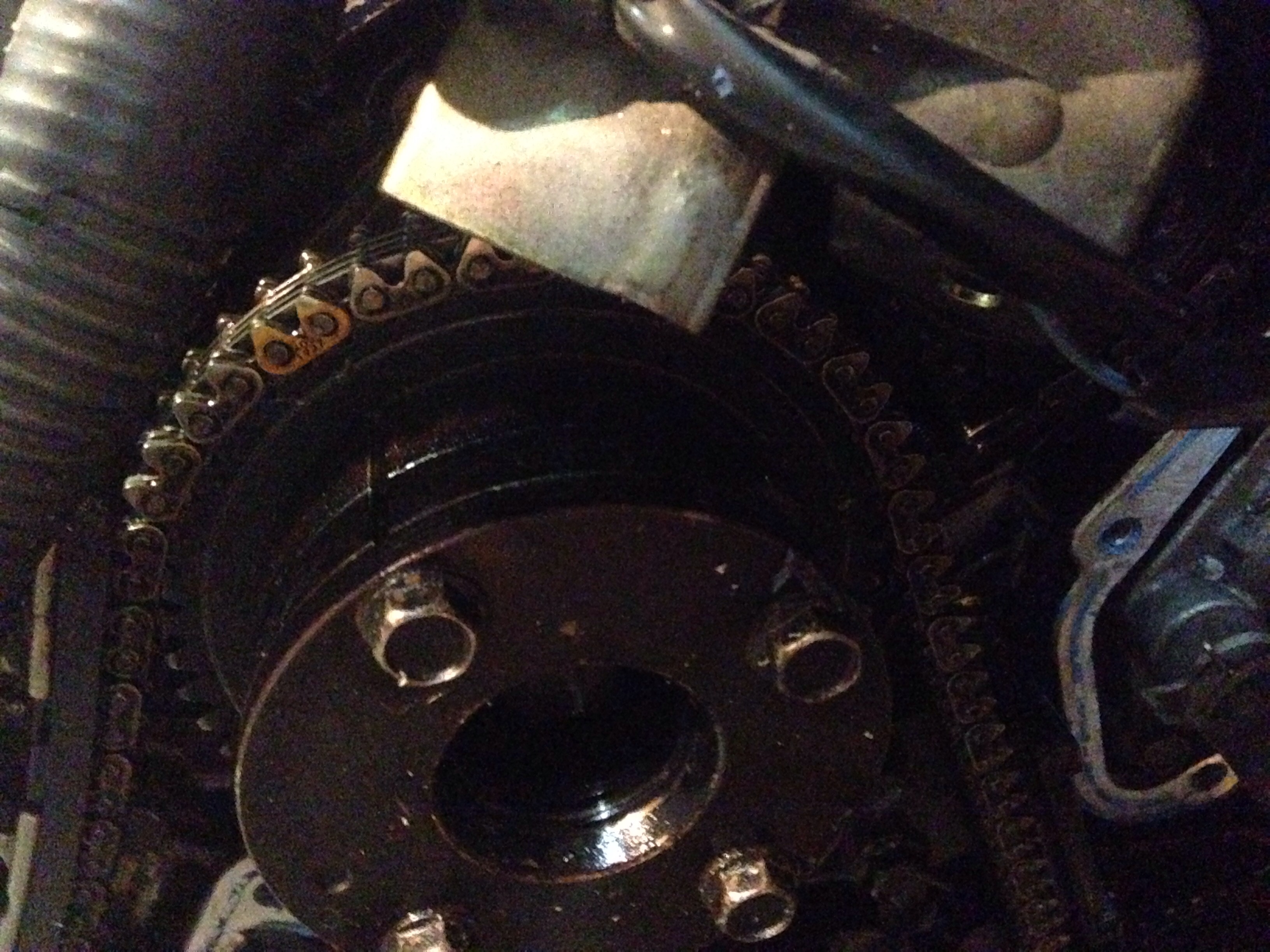

Left cam gear

Right cam gear ( sorry about the multiple posts, would only allow me 1 pic at a time)

I have never checked for tdc with a gauge that way. But it's gotta be on the right stroke of it makes pressure there because the compression stroke is the only upstroke with all valves closed. So you must have the correct stroke. I am not at home to check the manual From memory and what I can see in the pics the main chain looks dead on. Are the marks on the secondary chains lined up?
Edit**. Got home to my manual. To my eye the main chain is correct. So as long as the two secondary chains are aligned I believe you have it right.
Just double check it all again with your own eyes before sticking it together. It's tough for me to see the little marks in the pics.

Yes the secondary chain lines up with the marks on the back of the sprockets and on the dowel pins at the end of the camshaft.

And te two gold links are matched to the 2 dots on the exhaust gear? Just being thorough. .
