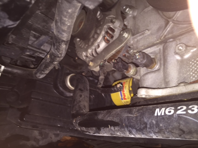

If you can just cut them with 6-8" leads. Can you take pictures of them and possibly give me what the number on them is. I want to make sure they match up. My connectors have been fixed but I am trying to find replacements for future issues because we had to splice right at the connector.
Here is pictures.

The one of the left is your oil pressure sender. The one on the right looks aftermarket as maybe a temp sensor?
they dont generally have numbers on them. I know exactly what connector is for the Oil pressure sensor and traced it back through the harness. Ill provide a pic.
Can you get a better pic of the two wire on the right.
