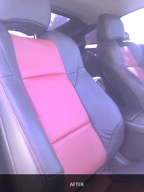

Thanks for your help. Stupid me, I accidentally tucked a power cable in with the new seat covers. I had to remove the seat covers and find the cable again. Thanks for the input. Here's an image of my before and after work I did.
