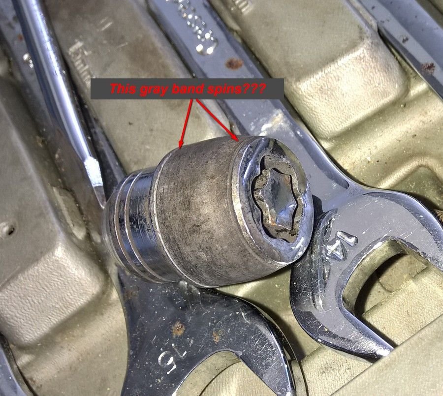

This is one that I managed to get off before the key shattered. The grey band between the chrome top and bottom is not part of the main body, but spins if you manage to get a grip. I can get sockets on it but they just spin.
Hence, MicVelo, I doubt that the remover would work, even if I ordered and waited the two weeks. Will go by the store on Monday to see if they have a solution or another set with the right key, else I have a date on Wednesday with the dealer to replace the bearing on that corner anyhow, so I'll let them have the headache

Originally Posted by MicVelo
Yes, it's a free band around the nut. Prevents use of the nut removal tool, which anyone can buy.
OK, now I get it. Wondering if the "band" can be cut off with a cutting wheel or dremel since it's a free floating ring. Slice it it up one side, down the other then remove with a lug remover.
I know it's moot since you're having the dealer do it but for future reference by anyone else facing the problem....

I'd go at that spinning band with my air hammer and a point chisel. Then I'd unscrew the security nut with a nut extractor like from an Irwin Bolt Grip Set after dousing the lug bolt with penetrating oil. You'll probably need to replace the lug bolt, but that's easy.
Another idea: Grind the chrome off the top of the security nut and weld a 1/2" or 5/8" nut to it. Should screw right off.
