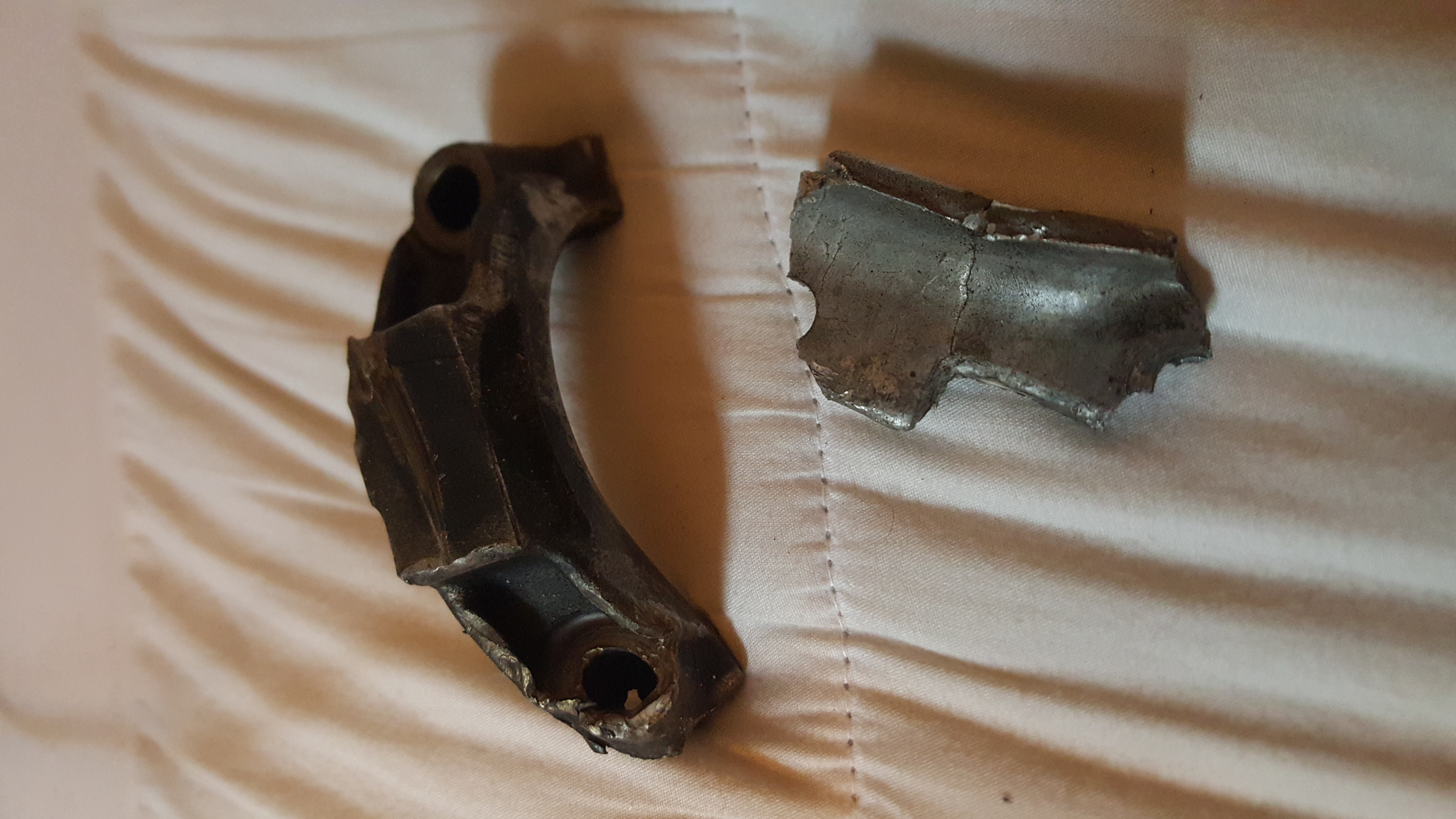

I was pulling down my driveway when she broke down, luckily... But the car always had a clicking noise when the clutch wasnt pressed, mainly audible when idling. I purchased it about a week ago, and the dealer said it was just the throwout bearing.
Anyway after a day in town at my gfs house, on the way home the clicking sound was up tempo, louder and rough, like grinding. The acceleration was weaker btw. Everytime i slowed down, the car engine would shut down. That happened a total of 3 times, each consecutive the car struggled more to turn over and the loud "rough clicking grinding" noise would intensify.
Eventually when i got to my driveway, of course you have to decelerate, the car turned off. I started it up "barely", and the sound was way worse. I just about shifted into second, and stuff happened... it turned off, I heard metal drop from underneath, and the car started smoking...
After parking, i went to go pick up what dropped, and it looks like a metal chunk, and broken clamp, which there was a spill trail of some sort of fluid.
The car wont start at all. Soooo guys, what could it be?

The two pieces i recovered.

The two pics show a rod cap and most likely, a piece of the engine block. You comprehensively BLEW that VQ up, and should use this as one lesson from the school of hard knocks. You didn't mention whether or not any warranty was included with your one week old sale from the dealer, but this will be expensive.
Depending on what year Z you own, you'll need to totally replace the VQ35DE/rev up/HR, as the shortblock in your Z is no longer rebuildable. You'll need to carefully select a skilled wrench to do this, as it's not a job for someone that's "a little new" to cars. And while you might live in a part of rural Florida, or any isolated part of the country, the next time you hear an engine knocking like THAT, just park it and call for a tow, before you burn it to the ground (like what happened this time).
