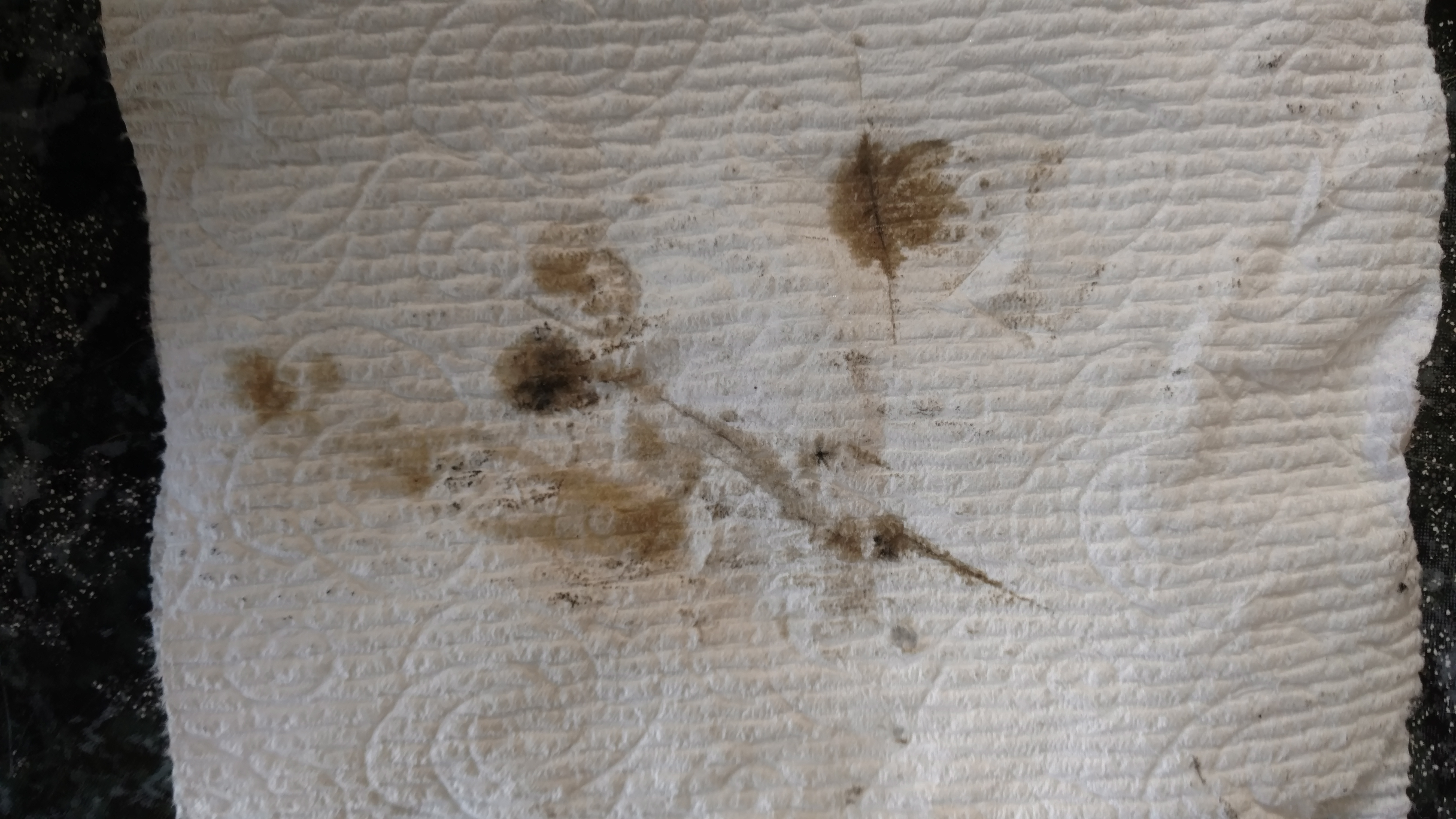

Here's a pic of the fluid on white paper towel. Seems to be engine oil right? I am going to try and get a sample of the tranny fluid to compare...

definitely oil, trans fluid is red

Thanks for the confirmation - so what am I looking at as far as resolving this issue? Can/should I use the car as long as I monitor the oil level or will this cause more damage?
