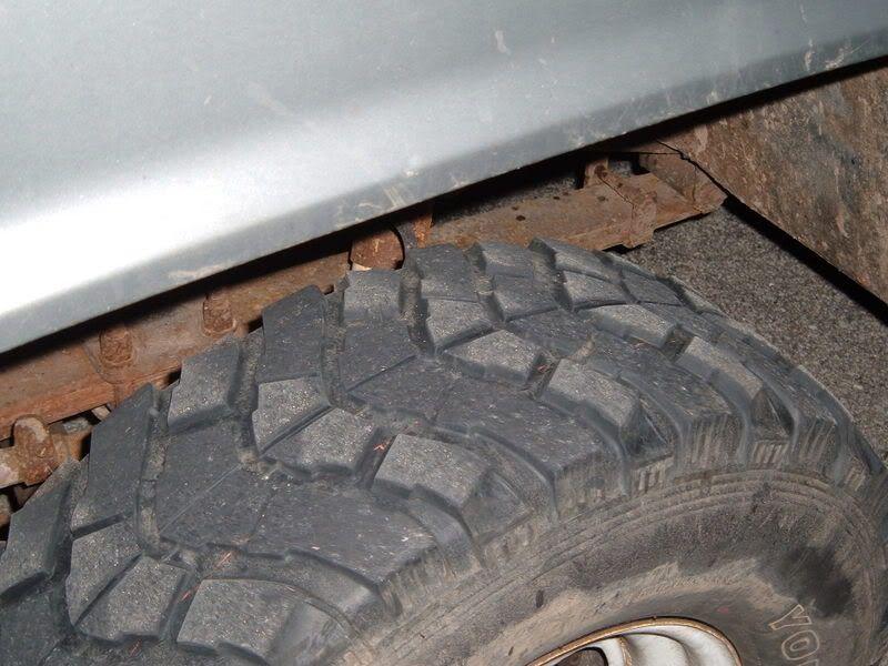

Originally Posted by Emski
^ Tire feathering. Run your hand over the tires to see if it's smooth.
This is a very common problem especially on mud tires.
here is a very severe example of the issue
If your individual tire tread patches feel or appear to be at different heights this could be your issue
