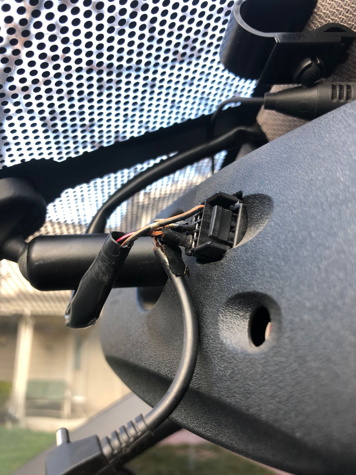

Well I got it figured out.
I went to remove the dash and bumped the rear view mirror. When I went to straighten it I noticed a little DC jack tucked in the back. Looked behind the mirror to find this beautiful wiring job. Pulled out the jack and fixed the wiring and we're back in business. Would've been a real nightmare if I didn't get soo lucky.
Thanks for your guys input.
