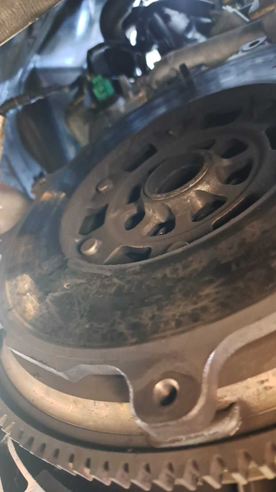

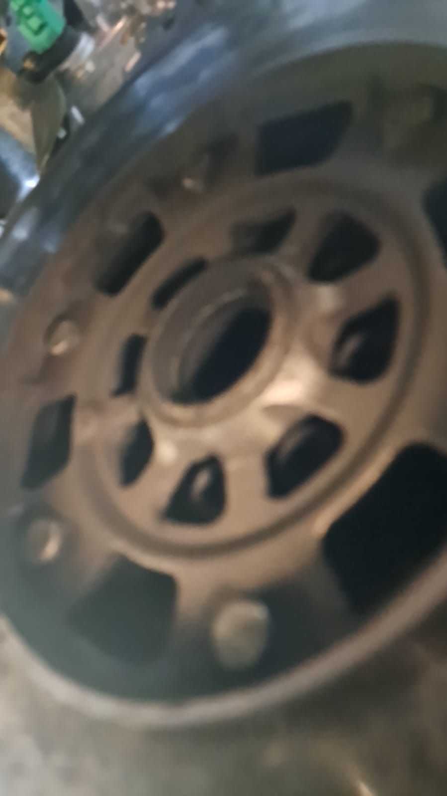

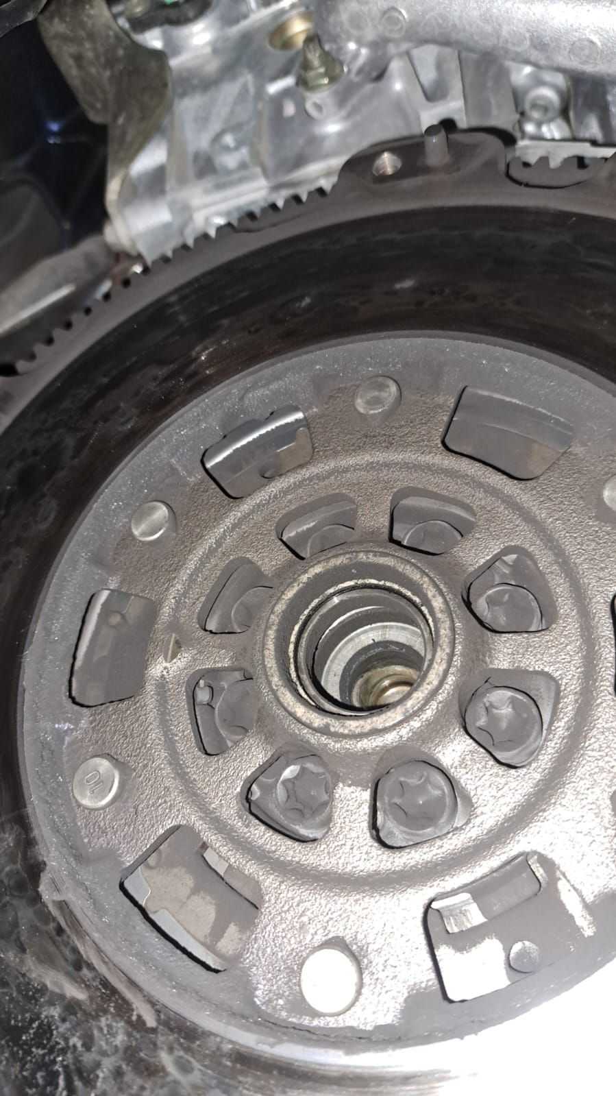

This is the original clutch kit on my Z, it is giving me problems and I have to replace it. Which one would you recommend me to buy?
Old Apr 20, 2023 | 07:16 AM
travlee's Avatar
travlee
Master
Joined: Jul 2011
Posts: 49,725
Likes: 9,296
i cant say without knowing if you have the external or internal slave cylinder

The car lost power, the gears did not enter correctly, the clutch pedal was stuck to the bottom on 1 occasion. And when we opened the part we saw that it was totally worn out.
I don't really know much about technical mechanic, but my mechanic recommended me to change the whole clutch kit, including the flywheel.
The best option I have found is this: https://www.ebay.com/itm/164355176269
Another option would be to buy a DE clutch kit from Z1 Performance, but at triple the price. I guess it is better quality. But I only use my car for daily driving, without stressing it too much. I really just want to get it running again since it was something I wasn't planning on changing at least in the short term.
Gotcha. The clutch pedal being stuck to the floor is a pretty common issue and that may not be the sign of a bad clutch/flywheel, but a failure in the hydraulic system.
But yes, that clutch flywheel combo should be fine, I guess. I don't typically buy ebay parts for vital components, but I get that you're on a budget.
I hope it works out!
