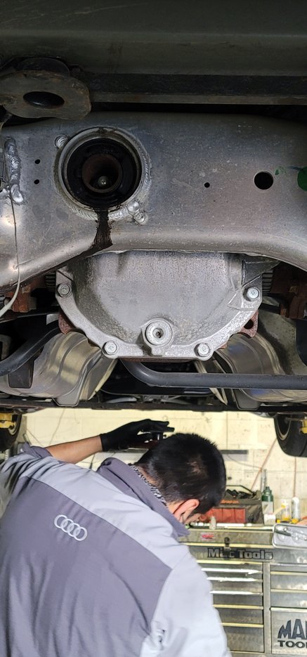

How much would it cost to repair a leaking rear differential? Here is a picture.
Thanks!

Paying a shop or DIY? Aftermarket solid differential bushing sets run anywhere from $50-$125. If paying a shop, the labor is going to cost the most since they'll probably charge you to drop the subframe even though that's not absolutely necessary.

Paying A shop unfortunately

Buy the bushing and the removal tool and instructions and bring it to an independant shop. Should take about 2 hours. So ~700$ total. You'll have no warranty most likely because it would be customer supplied parts.

Hmm so i was quoted 600 which by the sounf of it is fair. Thry said parts is 100 and labor 500

That's a pretty fair price for labor in CA considering the effort required to remove the old bushings. Just make sure they use quality aftermarket replacements.

Good to know ! Hea ordering rhe differential bushing from Z1 website and its $100. Seems better than OEM I think

The urethane bushings are the way to go over the liquid-filled OEM which will inevitably fail. Solid bushings seem like overkill for street use. Which ones did you get?

Thry ordered these ones
https://www.z1motorsports.com/z1-pro...t-p-10356.html
