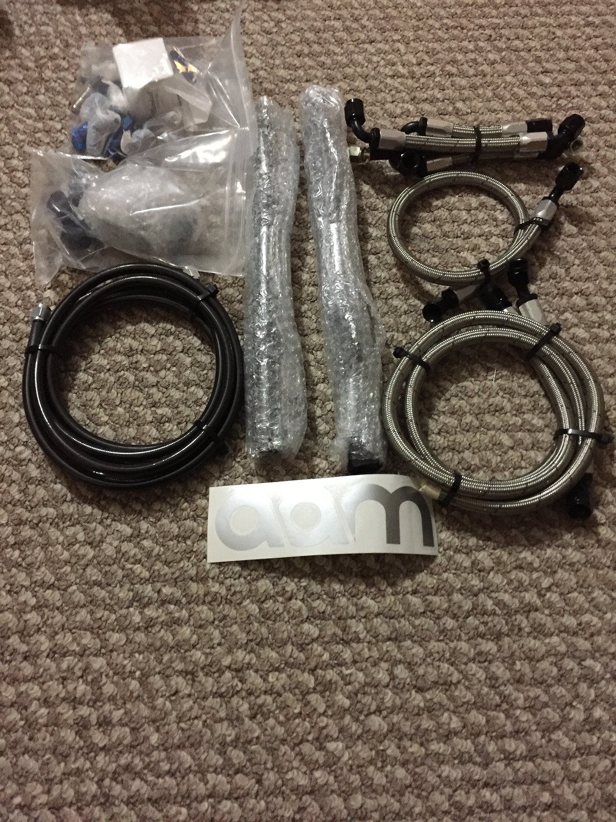

I had the Cosworth Plenum sandblasted and powercoated so it looks much nicer now, aswell as some of the vortech pipes. Had to custom weld the Bypass Valve onto the pipe since it was much bigger than the factory vortech valve. Also did some work on the transmission since it looked terrible. Bought some Stillen Headers and AAM test pipes, which added some power and gave the exhaust a much different tone and sounds a tad bit louder... I went with a Stage 1 AAM Fuel Return System, which i dealt straight with AAM (also with the test pipes) they were fantastic to deal with, and fast shipping. Also got a new battery, alternator, polished throttle body, NGK step spark plugs.

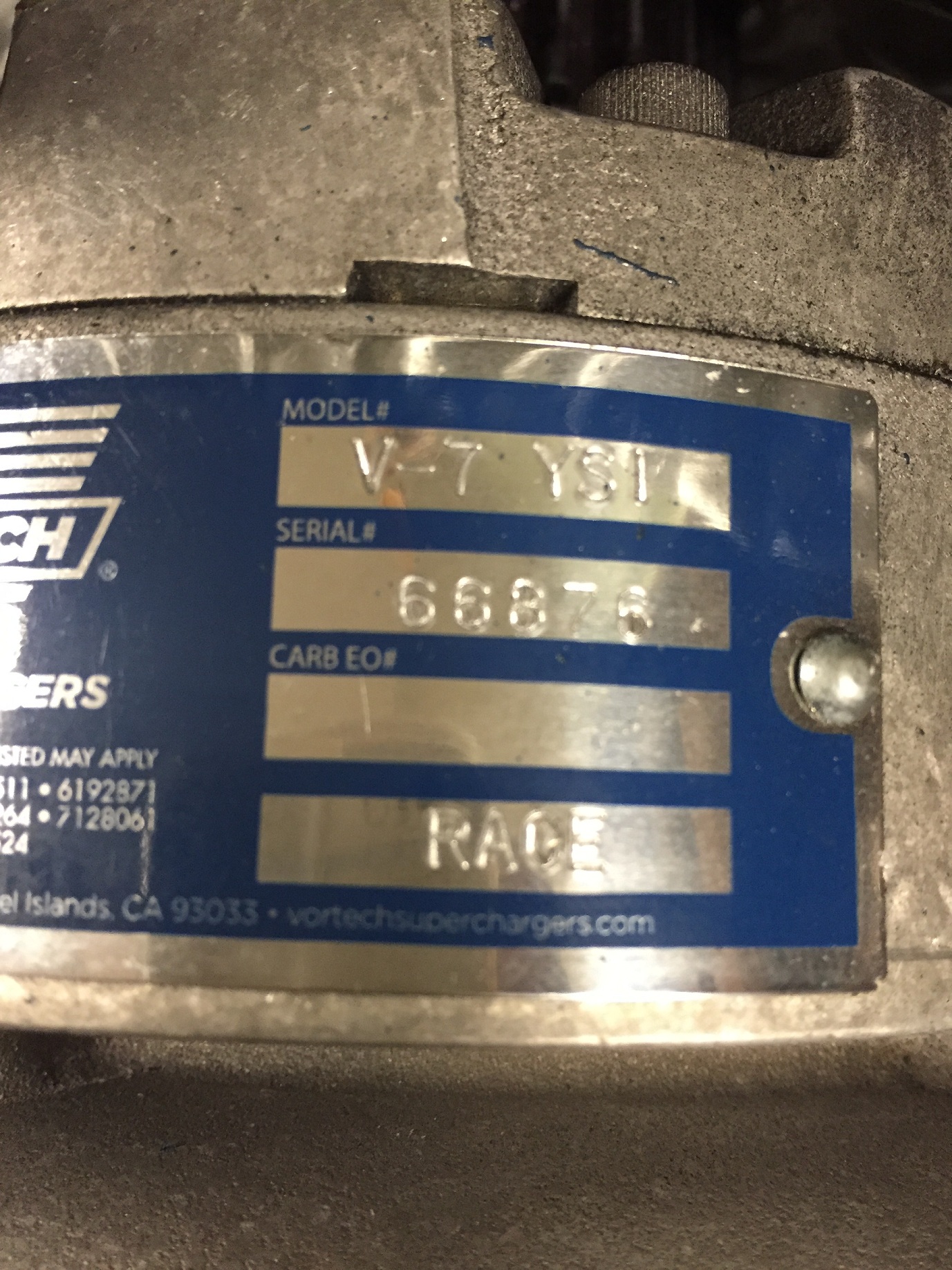

That's how it currently stands but I just got the Vortech V7 Ysi Supercharger so that will be the next step for my build. Install on that will be very soon.

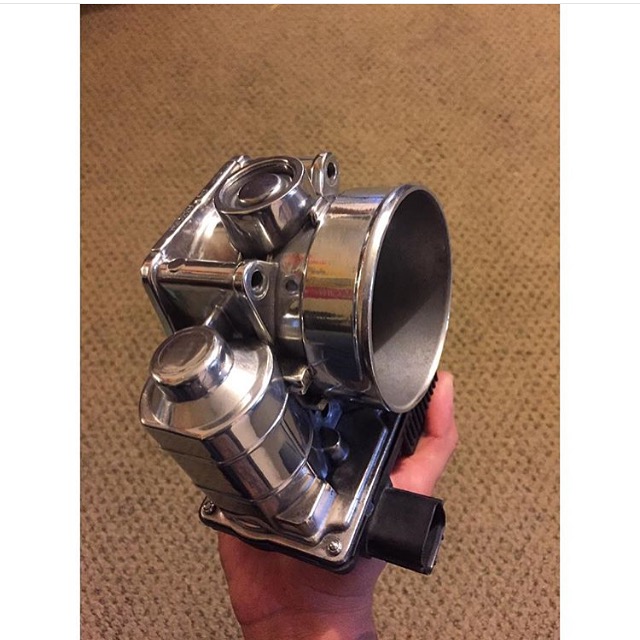

Bought AEM Infinity ECU with a plug and play harness, Fluidampr Damper, 1000cc Deatschwerks Injectors, CJM Twin Pump, and NWP Throttle body.
I should have everything I need now to install my V7 Ysi and make some more power!

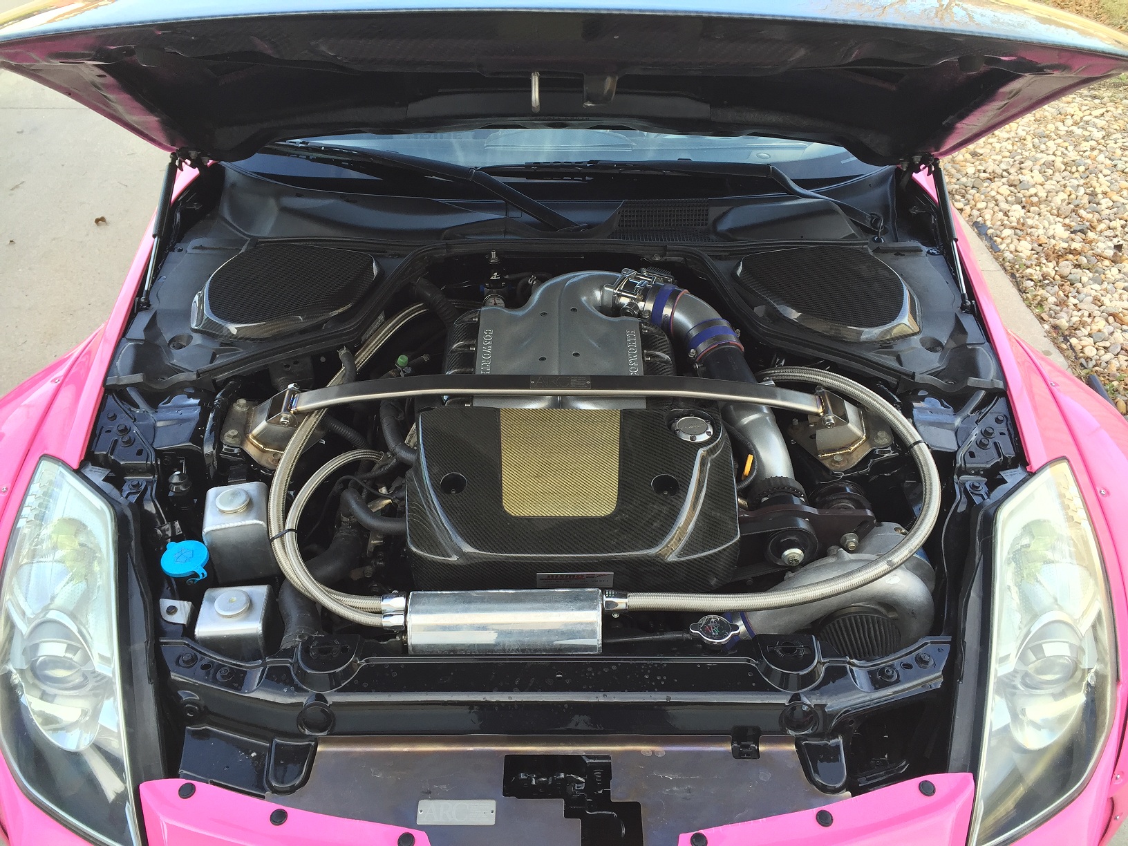

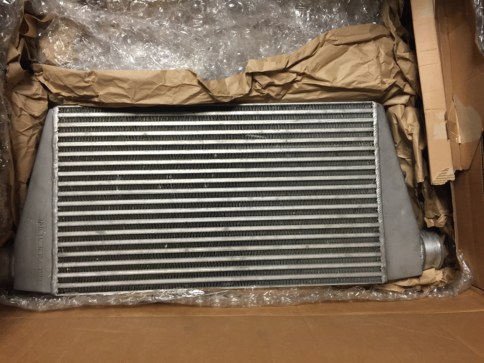

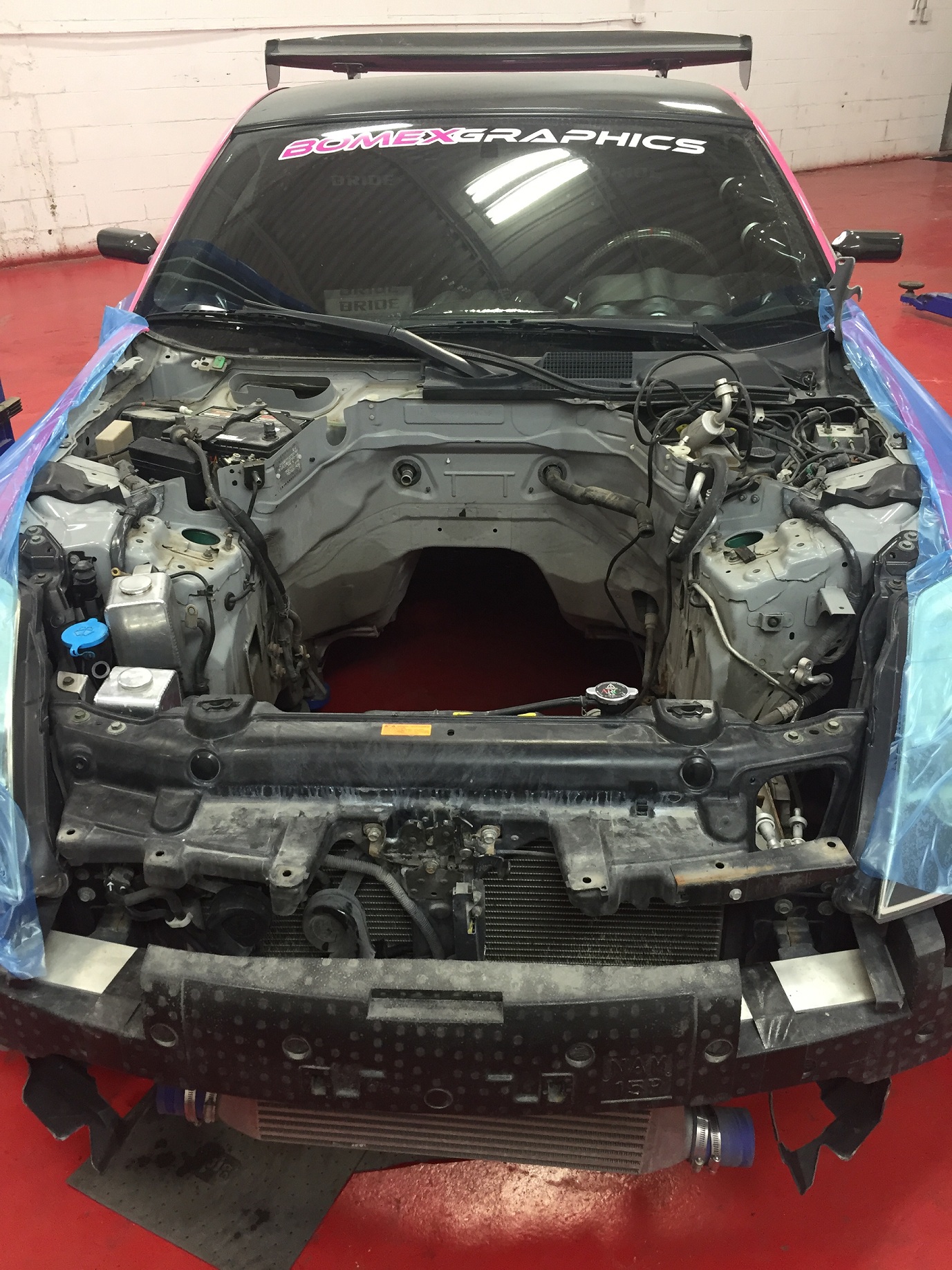

Installed my Vortech V7Ysi setup. Installed the CJM Twin pump, Treadstone TR1245 Intercooler (welded to my crash bar), 1000cc Deatschwerks Injectors, NWP Throttle body, Tim Rod Brace, ATI Fluid Damper (chose not to run with the Fluid Damper as the ATI will help me get more boost and push the V7Ysi. I also added in my HKS Carbon fiber engine cover.
Got rid of my rear wiper, added a carbon wiper delete cap.
Also got my Airtekk Air Struts and my Accuair Management System installed.
Next up is my AEM Infiniti Ecu. Just waiting on my harness to get this baby Tuned! Stay tuned for some numbers.
