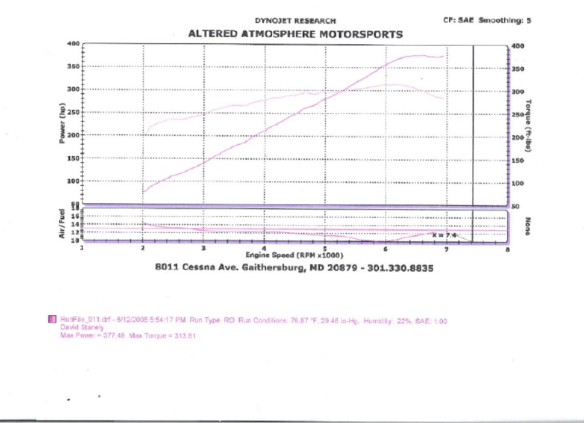

dyno report and air fuel:

Hmm A/F is right on 12's A/F too lean imo for turbo Z's (heat) but more acceptable for S/C Z's, although I wouldnt be happy with that. Its actually off the scale rich from 5500-6200rpm's, if they can get it that rich at 6000rpms I dont understand why they cant do that earlier in the powerband. Hows the car feel? Do you know how much timing your running at redline or how much is retarded over stock? Im curious to see....thanks for posting.

the ati is loud as hell. so, there goes my plans of sneaking into capitol and making a 12 sec pass and suprising some mustangs and camaros. anyone that knows anything about cars will hear me a mile away and know what i have.basically it sounds like an airplane that is taxiing to the runway before take off but it isn't too bad from inside the car. on the road it feels pretty nice, pulls pretty hard and goes sideways on the 1-2 shift but i'm not sure about the timing details. i know that there is some detonation around 6400 so i'll be taking it kind of easy at the track until the fuel is straightened out. too bad there isn't a MIR or capitol day coming up. seems like i missed everything.
