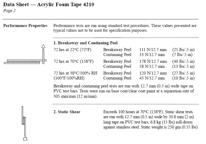

I would say DON'T Drill, because reversing that will become costly. Most people don't know it, but 3M makes some ridiculously strong double-sided tape. If you use their body moulding double sided tape, you should be fine.
Here's a spec sheet on one of their tape products, and you can see it's more than adequate to hold even a heavy emblem

As JT said, go with double sided tape. Check the strength before purchasing. You should be fine.

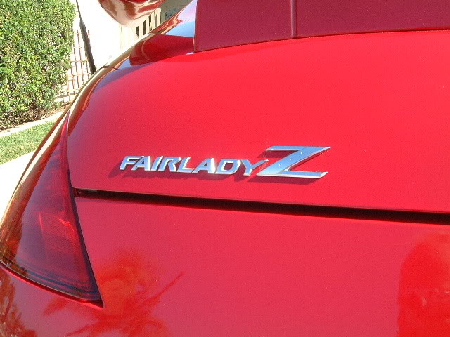

Mine replaced the 350Z emblem. The Nissan emblem is still there.
