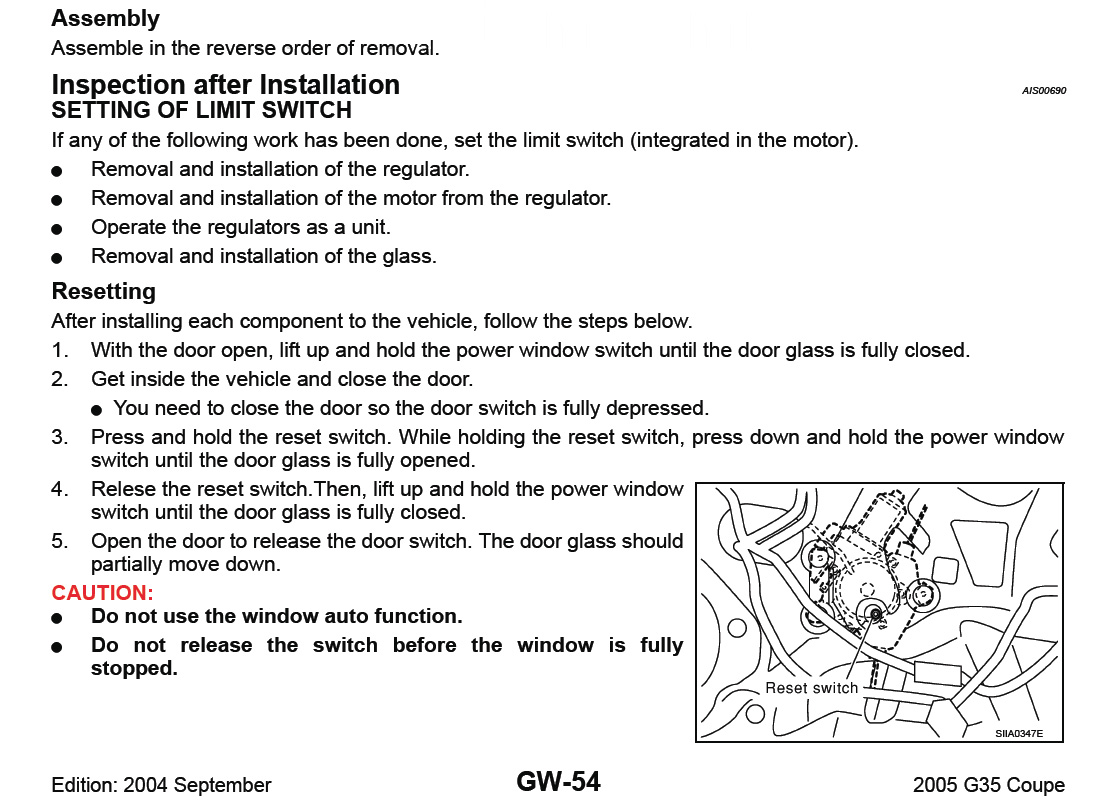

I need my passenger window reprogrammed, the stupid thing keeps rolling down when I shut my passenger door. Anybody know somewhere that can do it cheap? I called my dealer and they said it's not covered under my warranty, and its $96....

it's something like, roll down the window all the way, holding onto the button until it's fully rolled down. then holding the reset button on the window motor and holding the window roll up button until it's all the way up, right?

Its easy to do, save the $$$ spend 30 minutes and go for it. Ive done it on both of mine along with replacing window motors.
http://g35driver.com/forums/attachme...0&d=1206367810
^from g35 service manual...but same procedure for Zs
damn sounds like too much work i would try before pulling the panel..get in your car press and hold the switch like albert said untill the window is all the way down + 5 seconds and then pull and hold the switch up + 5 seconds and see if that works. i know it isn't a toyota or mitsubishi but the scion tc's and eclipse's work that way for reinitilizing them! GL
i thought they were referring to the procedure i linked
never heard of doing it the way you stated...but if it works...cool
also, taking off the panel is really easy
