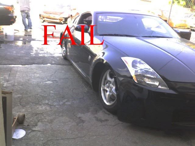

Wrong offsets on a 350z make it look like a FWD car.

^^^that's a little over exaggerated. The offsets are fine with the ones I am getting

Kyle offset is where the center hub of the wheel is located. If it's at the dead center it would be +0. So if your wheel is 10" wide +0 offset would have 5" width measured from the hub toward the fender. More positive the wheel is more tucked, more negative the wheel sticks out more. Offset is measured in metric system in mm instead of inches so it gets tricky.
