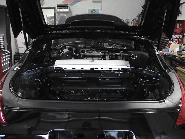

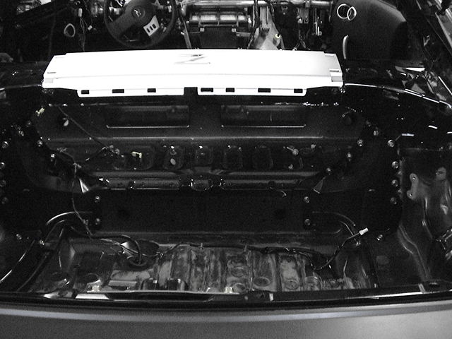

Does anyone have any pictures of the rear tower brace naked, i.e. with the plastic covers removed? I'm planning on installing racing harnesses and wanted to see whether the brace would be a suitable mounting point for the belts.
If you've taken the plastic off, how hard was it? Any tips, hints, or tricks to pass along?

But does anybody know how to remove the plastics?
Thanks.
It is easy, they are just held in place by pins, start with the two small top ones on the sides by pulling up on them and then you can work on the sides, I just lossened the long side ones enough to free up the silver piece if that is all you are after then the silver piece you have too pull to free it, just make sure the two long ones are clear and don't hold the silver one anywhere.

Thanks for the pictures. Being all black, it's a little hard to tell what we're looking at. Is there a hard beam under the bent sheet metal to which you could mount a harness?
