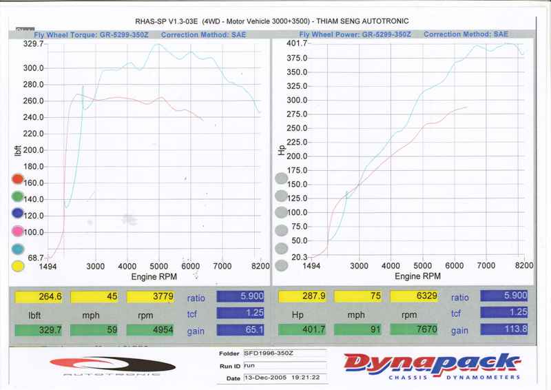

401.7hp at the fly wheel @7670rpm
321.3whp @7687rpm
329.7 lb/ft fly wheel torque @4954rpm
263.7 lb/ft rwt @4970rpm (I will need to check this, it is reading by a factor x final drive on the print out)
Dynapack Chassis Dynamometer
Fuel: HKS Drag Racing Fuel
95 degrees F.
>90% humidity
Scan will follow tomorrow when I get to the office.
Tuned by Lester Wong - HKS Technical Factory Singapore.

Originally Posted by jmccarty
It is done, I will scan it in the morning.
321.3whp @7687rpm
95 degrees F.
>90% humidity
Finally tracked you down. Was great meeting you at Garage R earlier this evening.
Wonder if there are anymore my350Z members in Singapore.
Anyways...nice car and nice dyno graph...still can't get over the pig tail in the graph...you better explain how that happened when you post the dyno graph up
Cheers Discom! It's the friction brake engaging.
You will see it up in the morning.

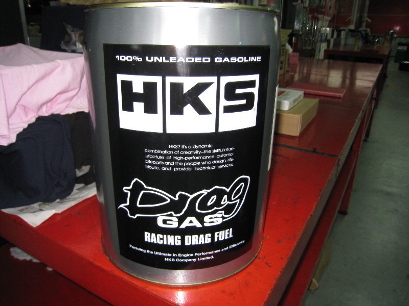

Good torque #'s and right where it should be power wise given the mods
I'm sure the race gas helped given the temp and humidity too, so good stuff - what were the pump gas #'s?
We used 100% HKS Drag Racing Fuel. They don't actaully publish the numbers. I'll ask again tomorrow at the shop and photograph the 20litre cans it comes in. I was going to go with VP MS109 but the supplier ran out so went the extra on the HKS fuel to finally get the tune and dyno done. I'll let you know what HKS will let me know.

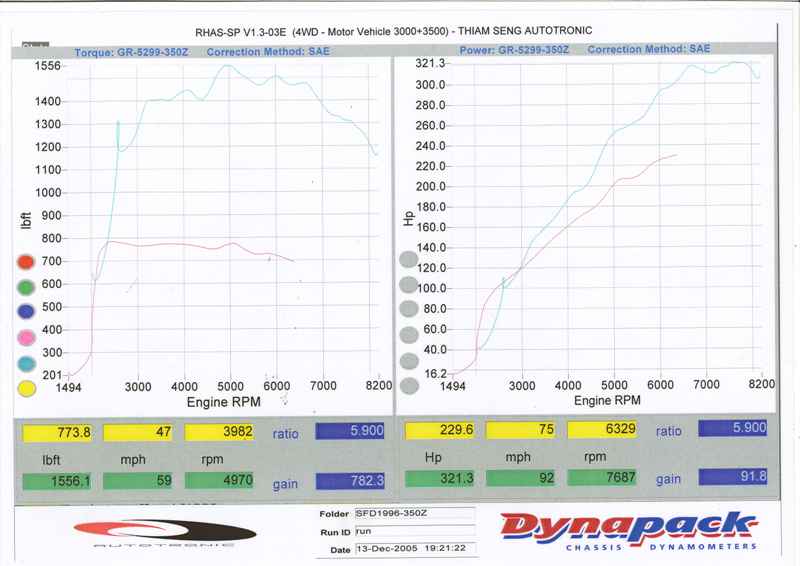

Default 401bhp/321whp
Here they are!
The torque wheel power is calculated by the lb/ft scale/the ratio (which is 3.9 final drive + 2 for the dyno drive so 1,556/5.9 = 263.7 lb/ft)
The date on the file is not correct. It was done last night (30 March 09).

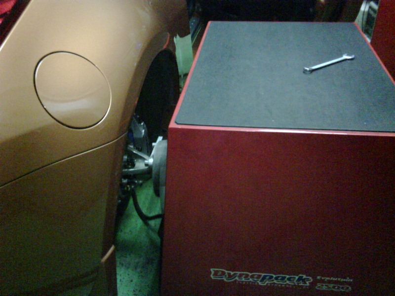

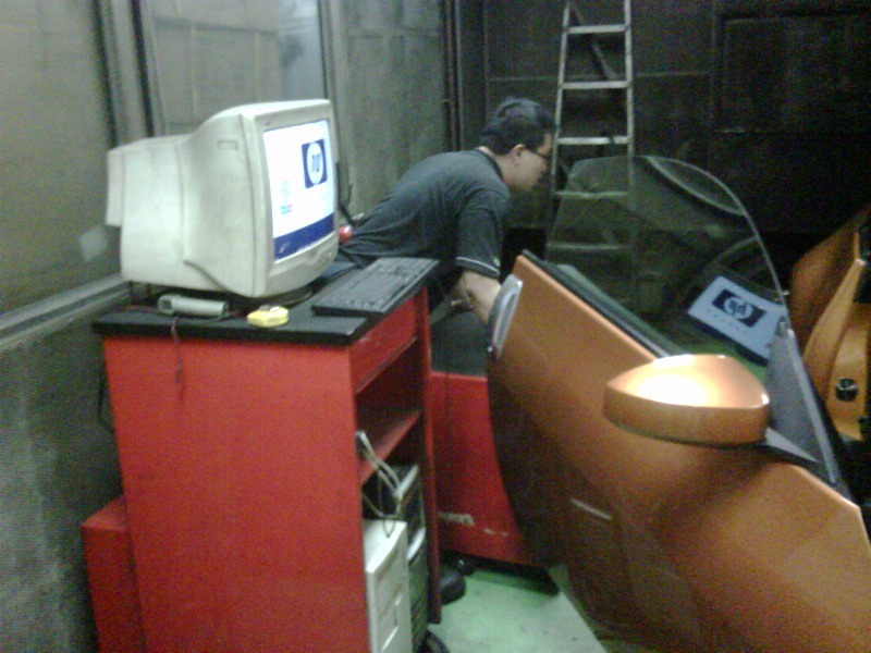

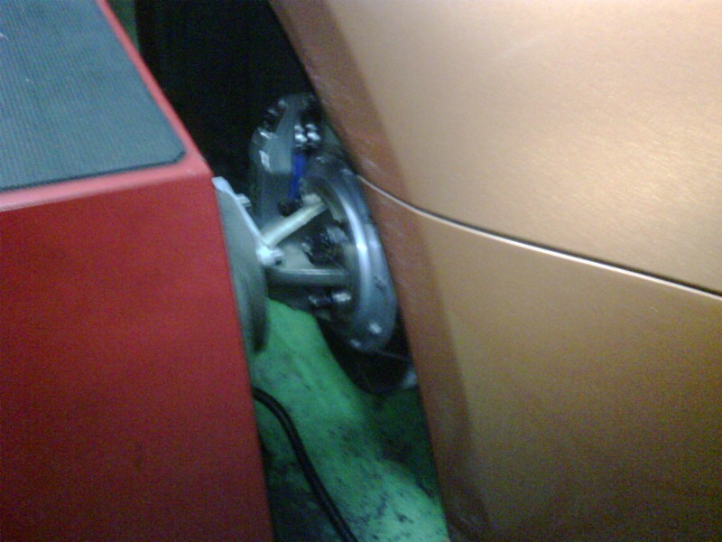

Here is the setting up.
Attached Thumbnails Cosworth 3.8L VQ generates 438hp NA-setting-the-dyno-up.jpg   Cosworth 3.8L VQ generates 438hp NA-r-left-wheel.jpg   Cosworth 3.8L VQ generates 438hp NA-r-right-wheel.jpg
Z1 - All I can get is 110 from a spec sheet in Japanese. The can does not say and the spec sheet is in Japanese and only has one rating.

did you do any dyno runs on just normal fuel, or only the HKS race fuel? Just curious
enjoy the car!
