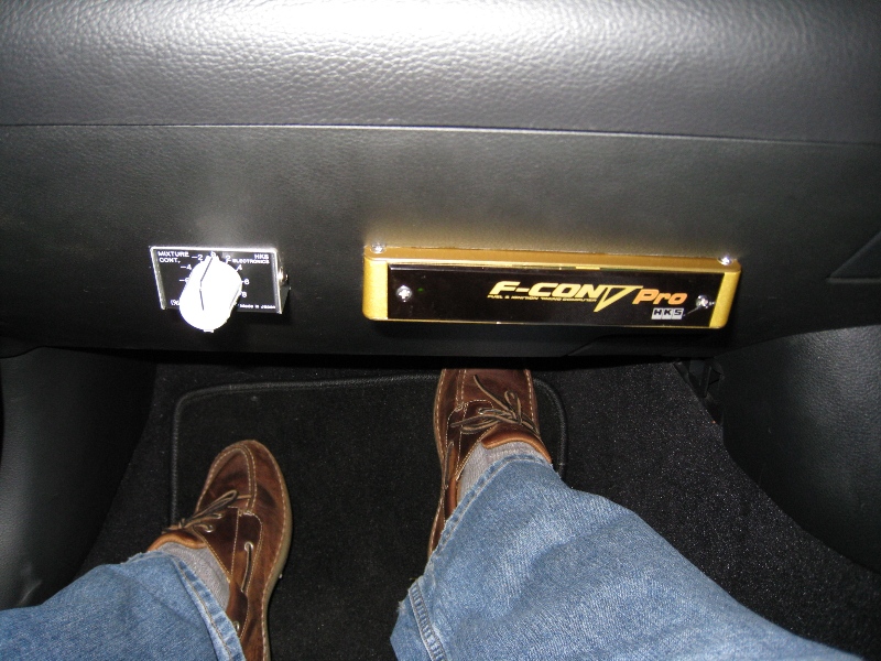

Originally Posted by Z1 Performance
did you do any dyno runs on just normal fuel, or only the HKS race fuel? Just curious
enjoy the car!
Only dyno'd on the race fuel.
I ended up with 4 maps:
-6: ??octane we get in Malaysia or Thailand. This could by 89-94 pump octane
0: Singapore 98 octane (or VPower from Shell in Singapore)
+4: 98 octane (Singapore) + HKS DHOB additive.
?? HKS Drag Race Fuel - Can only be set by HKS tuner on the day.
I probably should try a 98 octane run to see what we get.
Attached Thumbnails Cosworth 3.8L VQ generates 438hp NA-mixt-cont-and-f-con-vpro.jpg
