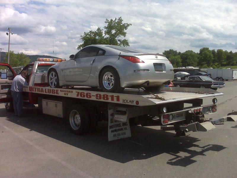

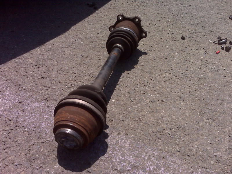

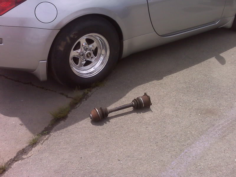

Oops

So you busted an axle on the first run? Or did you atleast get a few in before the axle quit?
Old Jun 14, 2009 | 06:35 PM
  #208
SnyperZ's Avatar
SnyperZ
Joined: May 2008
Posts: 1,175
From: Connecticut
First launch and it went pop. Ill try again next week.

you didn't preload the drivetrain enough.. 350z's are very tempermental.. you have to do more feathering..

bring the car up to a suitable RPM... 4000 RPMS.. 3000 RPMS.. and feather the clutch with the gas... when i had my maxima i would launch from 5000 rpms and feather the clutch... but i'm never tried that with a Z... anyway you have to slowly let clutch out to minimize wheels spin and shock to the drivetrain.. you can't just dump the clutch and kill the gas.. that will break the axles.. especially if you're running super sticky tires like slicks or drag radials

As I learned in shop class back in 1970, the weakest link in the drivetrain will break, best to have a clutch that can slip than a broken axle, IMHO. Something has to give. Tire spin, or clutch slip, or broken axle, or broken rear end, etc.

Well for now I welded the diff. Im getting a KAAZ diff at the end of summer but for now I need as much traction as I can get. My VLSD was smoked making all the power go to the driver side which is why I think it broke. I should be able to launch a little harder now without worrying about snapping one axle...I had a spool in one of my trans ams and it wasnt that bad other than parking and backing up.
